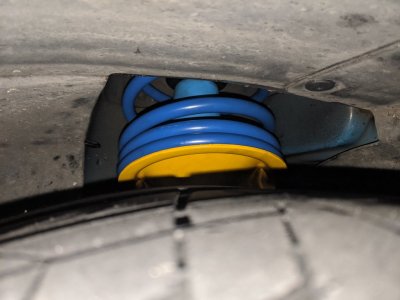

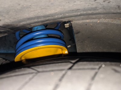

After installing the springs the first impressions are they they seem less stiff and more comfortable over bumps. When I exited my drive way I heard a single metal pop sound from the left. The car drives fine.
A short while later I heard the same sound from the right, once only. It hasn't done it since. As you can see from these pictures the spring could under load. Is it normal all mustangs sit like this when under it's own load on the ground. I am guessing those spring sleeves are to protect against the coils rubbing each other. I'm just concerned if I go through the hassle of removing the struts again that the strut mounts will need to be taken to a shop again to be removed.

Try retorquing the sway bar links, you have to get them very tight or they pop every time you hit a bump.
A single pop from each side sounds more like the springs settling in to the car's actual ride height, which is at somewhat greater spring compression than you put into it when you first install them on the struts. I suspect that not having the isolators is the reason you've heard it.
Coil spring diameter varies slightly as the load on the spring is varied, which is going to try to move the end coil radially against its seat. When friction between either end coil and its seat is exceeded, it'll slip and you'd expect to get a pop. Chances are if this is the case, the spring will have settled in at close to its proper equilibrium shape/position at static ride height and you wouldn't expect to hear it again unless the suspension moves by some extreme amount.
