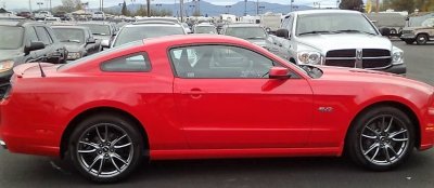

I had a 14 TrakPak Mustang. I bought it completely stock except a CAI and tune. The original ride was better than my 2019 PP1/A10 Mustang.
I didn't like the looks so, I lowered the car with Eibach Sport springs, WhiteLine adjustable panhard, WhiteLine LCA, UCA and poly carrier bushing, WhiteLine trans mount, aluminum one piece drive shaft, OE 2014 GT500 wheels and tires and other minor add ons. The Mustang would corner carve with the best of them, and on the highway it was as comfortable as my 2019 PP1/A10, which is bone stock.
If you are going to use Boss 302 Suspension pieces, don't waste your money as they are basically no different than the TrackPak pieces. If you want it to ride nicer, as everyone has suggested, the springs, shocks, and bushings are the key, not swapping parts from a Boss 302, just go back to the standard TrakPak suspension parts and replace all bushings with OE rubber or even GT500 rubber bushings.
For me, the stock TrakPak was a nice road car, but corner carving left a lot to be desired.

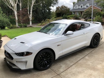

My 19 PP1/A10 although completely different chassis, is 10 times better than my 14 TrakPak ever was. I did a 1300+ mile road trip a month ago, going through Oregon, California and into Arizona and it was a very enjoyable two day drive. As for lowering the 19, no need to as I filled the fender wells with 265/40/19 in front and 285/40/19 Michelin Pilot's. The best tire for ride comfort and very little noise.
