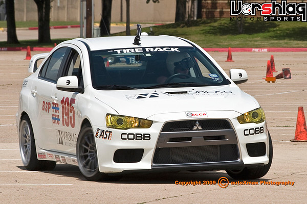

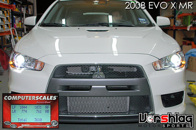

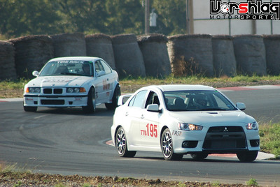

We had fun with the 3610 pound EVO X MR back in 2008-09. We used that to developed a number of suspension products (shocks, camber plates, shock mounts) as well as figured out better solutions for the wheels, exhaust, and even came up with some cooling fixes for the DSG's sequential gearbox. We had a lot of fun racing it in NASA Time Trials and SCCA autocross semi-effectively (it won some TTA events and did well in BSP autocross class locally).

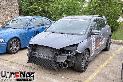

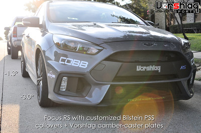

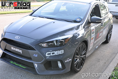

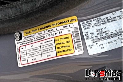

* We have since measured the alignment and this car came with 1/8" of total front toe out, which might explain the dartiness.

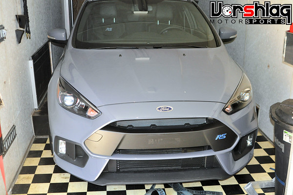

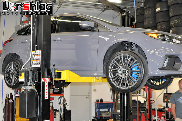

After shop manager Brad shot a few outside pictures we brought it inside and checked the initial ride height at all 4 corners, camber and toe front and rear, then put it up on the lift and slid our digital corner weight scales underneath to get a weight. As always I took a guess - without knowing anything about this car other than what I could see - and I guessed 3220 pounds. I'm usually pretty close on my weight guesses but this time I was off by over 200 pounds. This car had a FULL tank of fuel, which could explain some of the higher weight...

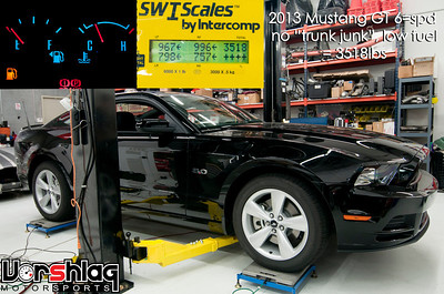

Wow, 3445 pounds full of fuel is a lot for a car considered a compact - but again, look at its competitors and they are all in this range. AWD definitely adds some weight to the FWD Focus ST, as do the giant Brembo calipers and 19x8" wheels Ford decided to put on this car. That would be the first thing I changed, by the way - the OEM wheels. The 235/35/19 rubber looks too narrow on this car and the sidewalls are too short, which might explain the ride harshness. We are pulling the wheels and tires + brakes off to weigh them now...

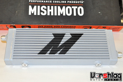

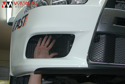

Ford used the old "scoop and flap" method of front brake cooling, just like on the 2015 Mustang and on Porsches since the 1980s. This is where a brake duct or in this case a low pressure inducing tunnel under the front end puts air near the inside front suspension, then a flap on the control arm diverts this flow towards the brakes. It doesn't work all that well, but its something.
With the weight this car has I suspect a dedicated brake cooling system will be beneficial for track use, so we will look into that for this Focus.

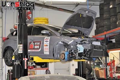

FOCUS RS DECONSTRUCTION
After the brief "intro" post on July 8th we had a chance to really dig into this Focus - by taking it apart and measuring lots of things. Our intent was to see what this car was capable of, and checking the potential for a camber plate design that utilized the OEM springs and struts. We also wanted to measure to see potential for wheel and tire width increases, brake cooling, engine cooling, etc. There were several eye opening discoveries which we have detailed in the pictures below.

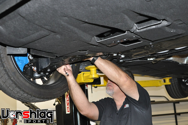

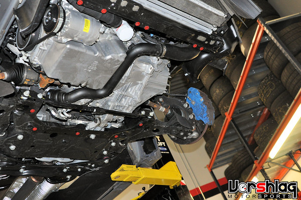

After getting the car in the air we started by looking at many things underneath, under the hood, and then dug further. Let's start under the car.

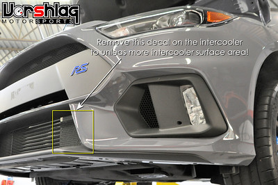

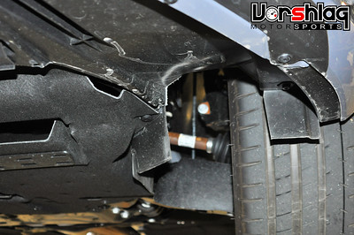

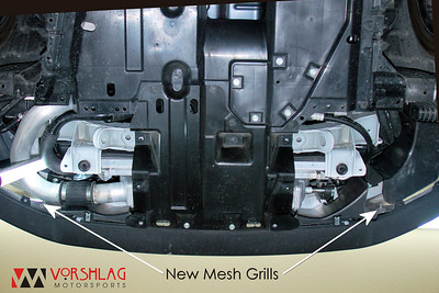

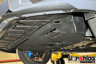

The RS front undertray is a hodge-podge of scoops and shapes...
This unusually shaped, extremely non-flat fabric/plastic front undertray has several NACA scoops to help direct air to hot things underhood. This would be a decent design if this fabric panel wasn't so flimsy and non-flat. We will look at a smooth bottom aluminum undertray (and short splitter) with the NACA ducts added as needed.

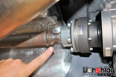

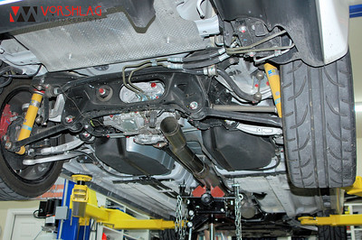

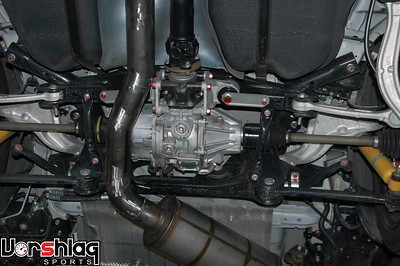

The diameter of the driveshaft that feeds power to the rear differential, or as the fanboys call it the "Rear Drive Unit" (RDU), is remarkably small. The section above right necks down to the size of my finger. How does this transmit "up to 70% power" of 350 hp to the rear wheels? Doesn't add up.
Not to mention the Rear differential itself, which is painfully small in the RS. This is the size of what you'd expect to see in a side-by-side or ATV that has a 500-750cc engine. Not exaggerating here; this differential housing is small. I've never seen a car with any sort of rear drive that used an axle this small in 3 decades. It is no wonder it overheats and disengages the rear drive, to protect this differential from damage.

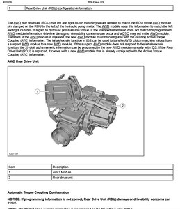

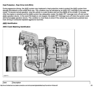

Some light reading from Ford documents that explains the complicated controls and overtemp protection on the RDU
After some digging through Ford documents, turns out this car doesn't even have a differential unit at all. There are electronically controlled clutches in the center diff as well as one for each rear drive axle. There are a network of computers, hydraulics, and robots controlling torque to each wheel. Lots of fancy doo-dads that are neat on paper, but terrible in practice. Hopefully there are some industrious folks who can crack the code and reprogram this unit to work better for performance driving.
This images above show the rear axle housing and rear suspension from a 2008 EVO X, which we spent two years tracking and autocrossing with. The differential housing looks like a similar shape but is substantially larger in person, and the rear suspension has aluminum multi-link arms. Just wanted to show what was available 8 years ago in AWD 4 doors.

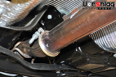

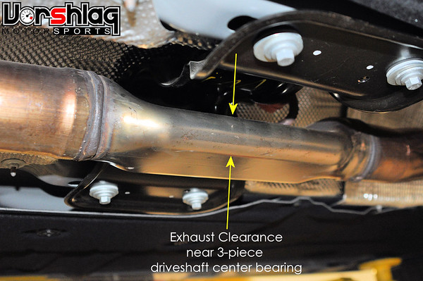

The Focus RS exhaust system is oddly shaped around one of the center bearings of the THREE PIECE rear driveshaft. Yes, this subcompact car with a 104" wheelbase, has a 3-piece rear driveshaft. Which is a bit nutty given the length, but that seems to be a theme in this car. The exhaust is smashed nearly flat there, but there is ample room to leave it full size there. The aftermarket can and will fix this.
Sure enough, Magnaflow has already responded with a better exhaust routing, shown above. No smashed section, no problem. Ford does this exhaust smash trick on a number of their cars, and it is mind boggling.
The rest of the factory RS exhaust isn't too bad, just a bit on a small side for a 350 hp turbo car. There is a bit of a gimmick feature out back - a computer controlled exhaust bypass valve which can bypass the muffler. Hey, even the Corvette Z06 has this. But it seems that some RS tuners are using this and some "tuning tricks" to make the exhaust "pop" and burble. To me this is akin to adding an exhaust whistle... If I see a tuner bragging about how they add this "feature", I will label them as a clown. #BubRub #WooWoo

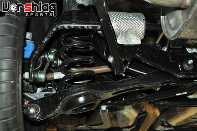

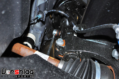

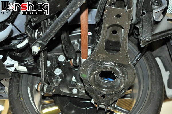

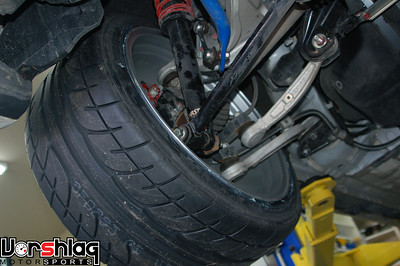

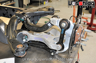

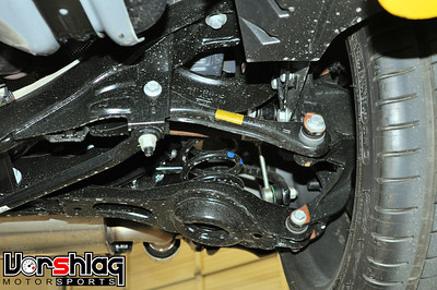

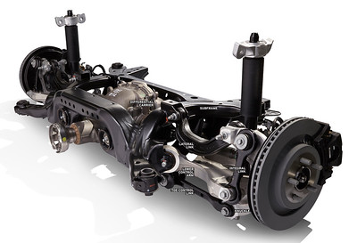

One of the worst features of the rear suspension is this trailing arm torsion blade. This is a 1960s-era design used on the VW bug, where you use a flat spring steel arm that can accommodate the suspension arc by twisting. This arm is needed to locate the suspension fore-aft during travel. Massive rubber bushing up front also allows for all of this twist. That front bushing should get a spherical. You only do this type of rear suspension to save money.
The rest of the rear suspension is heavy, stamped steel bits. Not an ounce of aluminum anywhere back here. This seems to have been done for cost savings. I would expect more from a nearly $38K car, but I guess I'm picky. At least they improved on the janky rear swaybar endlink design used on the Focus ST, but that is about it.
This Focus is made by the same company that designed and built the S550 Mustang (shown above), which has an independent rear suspension light years ahead of the Focus - and which can take real power to a properly sized rear differential. Aluminum is used on the throughout Mustang's rear suspension to save weight. And while some of the GT350 Mustangs (non-track pack cars) are seeing differential overtemp issues on track, it seems to be a programming glitch. This only affect the small portion of these Mustangs that even have a temp sensor in the rear differential housing. We've seen S550 Mustangs being abused on track for years with no long term negative effects.

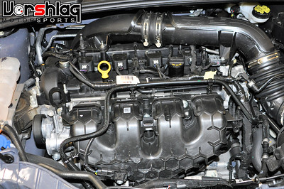

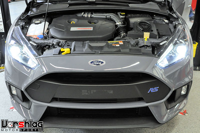

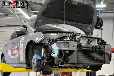

Engine bay in the RS is the definition of "tight". There's not a whole lot of space for a turbocharged 2.3-liter four-cylinder and transaxle that sends 350 hp and 350 lb-ft of torque to all four wheels. The bulk of the drivetrain is in front of the front axle centerline, which explains the 59% front weight bias. The Subarus and EVOs suffer from the same thing - they all tend to sit around 58% or 59% front bias.
Ford does the RS no favors by putting a full sized battery in the cramped driver's side corner of the engine bay, either. I'm sure they had their reasons, but this would be something I moved to the trunk area on even a semi-serious build.

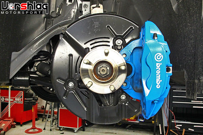

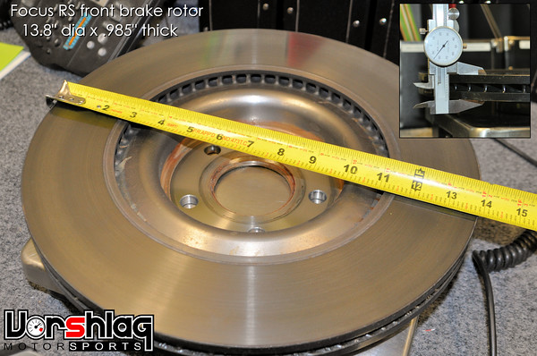

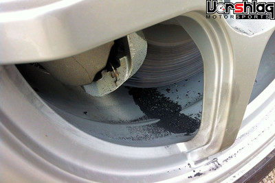

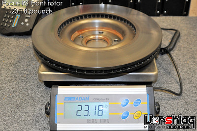

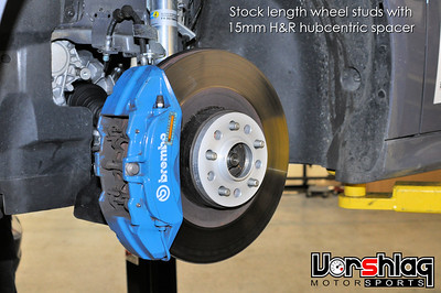

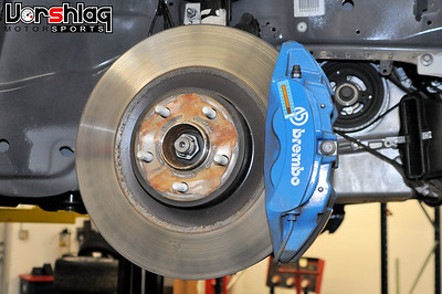

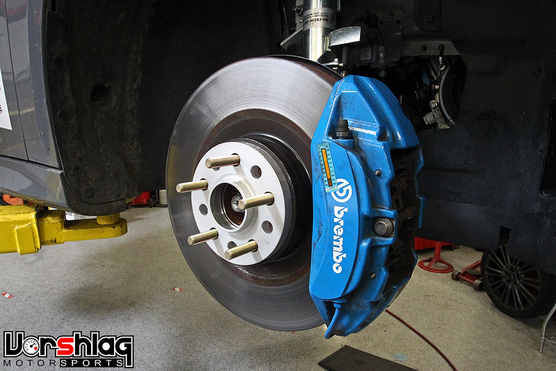

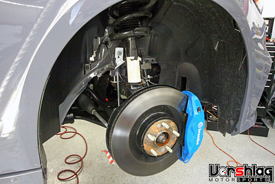

The best part of this car, to me, are the front brakes. The calipers up front are an OEM style Brembo 4 piston matched with beefy rotors. Lots of brake capability for a Subcompact car, and I we will talk about their track worthiness below. The front brakes are one of the few things on the RS that are matched well with the 3450 pound tested weight.
Now the calipers and rotors aren't anything magical - no co-cast aluminum brake hats or radial mount calipers - just a properly sized, OEM style 4-piston Brembo solution and decently sized iron rotor. Not gigantically silly or undersized, but just right. The front rotor weights and measurements are shown above. They are also not big enough to justify a 19" wheel - we could fit 17" wheels over these front brakes. Ford's 19" wheel choice was simply a fashion statement.

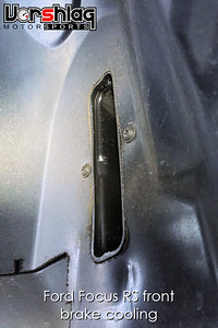

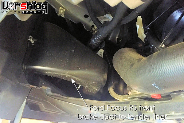

There is also an OEM front brake cooling solution on the RS, shown above and below. In the image above you can see the smooth plastic duct that takes air from a front scoop/opening and points it into the front fender liner.
Here you can see the fender liner exhaust for the brake cooling air (at left), and from here the higher pressure cooling air stream is thrown at a flap on the control arm. This flap, in theory, guides the air towards the inside of the rotor. We call this a "scoop and flap" brake cooling solution. No, its not as effective as a properly hosed/ducted brake cooling system like you see us build for race cars, but its better than nothing. I think it was Porsche who came up with this scoop and flap technique on factory 911s back in the 1980s? Ford has done something similar on some of the S550 Mustangs also.

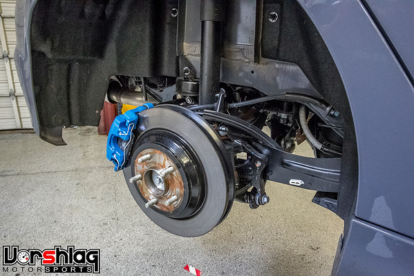

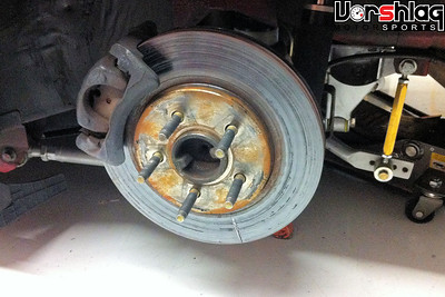

The rear brakes seem disproportionately small, and originally I suspected they were the same units fitted to the "rental car fleet" Focus, but I was wrong. When we sent the brake pad scans to our friends at G-LOC Brakes they assured us these were new pad shapes, so the small diameter, non-vented rotor and single piston sliding caliper might be unique to the RS. It is not impressive in size or style - but it should be cheap to replace when parts wear.

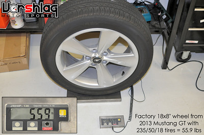

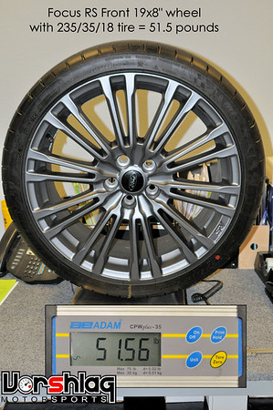

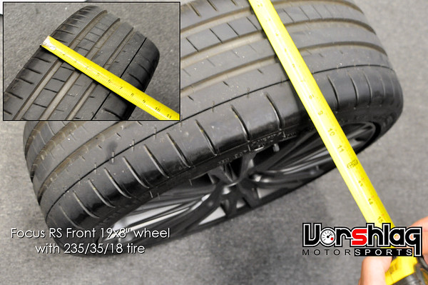

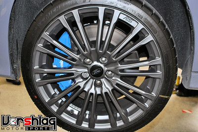

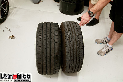

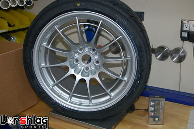

Here we see the weights on the somewhat heavy 19" x 8" factory wheels and 235/35/19 Michelin Pilot Super Sport (PSS) tires. There is supposedly another optional tire for these cars, but this RS was ordered with the base standard set knowing they would be quickly replaced. This 235 Michelin PSS shows to be 23 pounds on the TireRack website, so that means this 19x8" wheel should weigh about 28.5 pounds (amazingly heavy) if you do the math. There are definitely some pounds to drop going to a wider 17" or 18" aftermarket wheel - and we plan to measure for new rims after the coilovers and camber plates are installed. We will talk more about that in a future post.

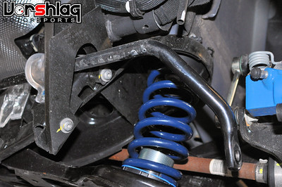

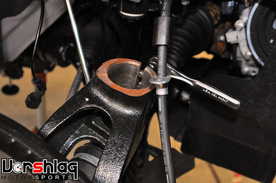

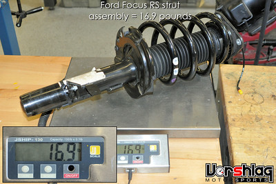

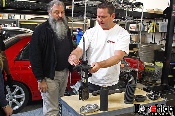

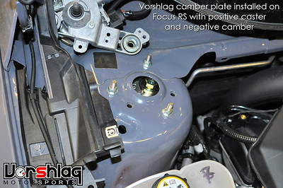

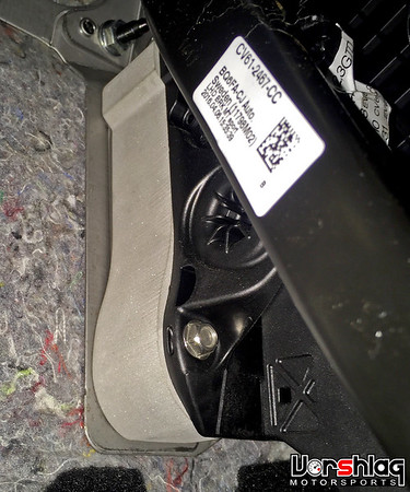

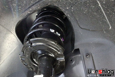

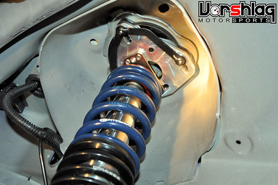

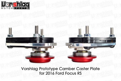

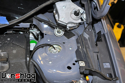

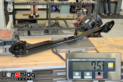

These are pictures of the front strut tower and strut/spring assembly. There is nowhere for the strut with the large diameter OEM spring to go - no room inboard - so there will be no OEM spring style camber plates. I explain this in more detail in the video below, "Suspension Challenges".

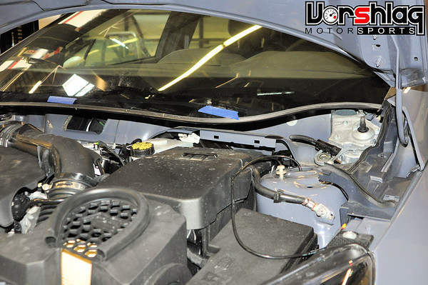

Just getting to the top of the strut towers involved removing about 19 layers of stuff under the hood. This is one of the most restrictive engine brace / cover systems we have ever seen.

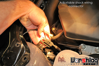

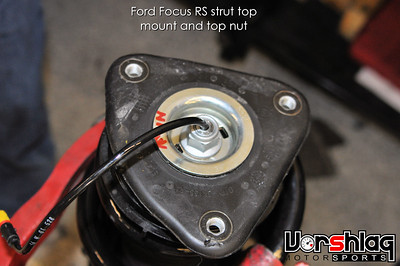

The wiring for the adjustable twin tube shocks has a connector above the strut tower brace, shown above left. The wiring passes through the top of the brace as shown above right.

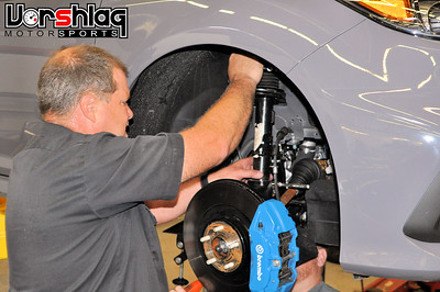

After 90 minutes of careful removal, we could finally see the tops of the strut towers and the strut top mounts. The factory RS engine and strut tower brace is crucial and must be retained. It is 7.5 pounds of stamped / welded / fabricated steel. This elaborate brace ties into a number of items, like the strut towers, wiper motors, and lots of plastic covers (aka: Tupperware) that hide the back of the engine bay and strut towers. The OEM strut mount is unusual in that it is bolted into the tower via bolts from above. This is backwards from nearly every McPherson strut car we have ever seen, which usually have studs that protrude through the the tower from below.

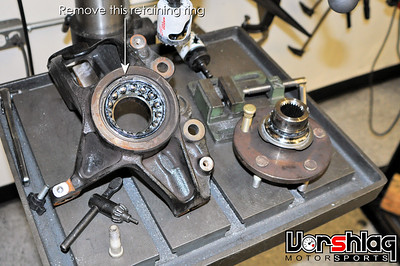

After you can access the top of the towers, actually removing the front strut assemblies takes more time. Support the bottom of the control arm, remove the front swaybar end link, disconnect several wiring connectors, then unbolt the strut to spindle clamping bolt. Spread the split in the spindle clamp as shown (above right) with a short extension square drive end. Then pull the lower control arm down. Now you should be able to pull the bottom of the strut out of the top of the spindle clamp. Once that is uncorked, you can unbolt the three bolts at the top of strut mount, freeing it from the engine bay.

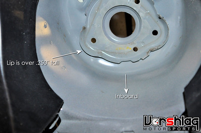

This unusual, raised reinforcement lip on the underside of the strut tower (above left) is another thing preventing a camber plate that could work with the OEM springs. Making a spacer to sit below that lip (so the plate could slide inboard) would eat up too much much stack-up height, so it would be nearly impossible to keep an adjustable top mount from raising the front ride height. Switching to an adjustable height coilover strut makes all of this moot - the smaller diameter springs allow inboard travel, and the adjustable spring perch height counter acts the slightly higher stack-up height needed to clear the raised lip under the strut tower. The OEM strut + spring + top mount weights nearly 17 pounds, as shown above right. Coilovers always seem to weigh less, which is a bonus.

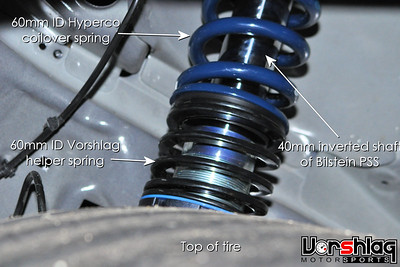

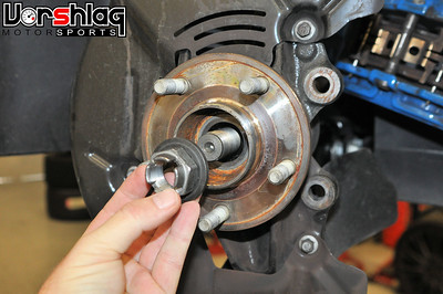

After we finally had the strut off the car and the spring compressed, we were ready to remove the strut top mount. We wanted to remove the coil spring so we could digitally rate it, but we stopped short. Why? The wiring for the adjustable shocks could have been ripped when removing the top mount. Yea yea yea, "it looks so easy". Trust us, it wasn't.
To remove the strut top nut would require an impact to spin the nut loose. Even if we custom made a "windowed" socket to allow the wire to pass through, we would have still probably ripped the wiring, ruining the OEM struts. With the chances of making an OEM spring compatible camber plate at zero, we cut our losses and decided no not rate the springs until we had replacement struts. The space constraints made it obvious we had to move to a coilover anyway. This also means there is not an easy path to installing lowering springs (which almost never have enough spring rate anyway).

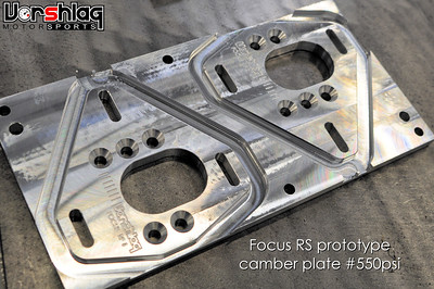

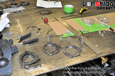

We are trying to point out the problems we see and offer up possible solutions. There are some good and bad things we noted here, but no super trick zero money solutions for improving handling performance. This video has a few thousand views already and lots of thumbs down. Blame the messenger, I guess?
PART TIME AWD SYSTEM
This internal Ford document about the Focus RS AWD system explains a lot. "During normal operation, most of the torque is delivered to the front wheels." is exactly how it felt to me all the time.
https://photos.smugmug.com/Projects/2017-Ford-Focus-RS/i-LWD4B7x/0/M/ford-awd-system-function-M.jpg
Read this and see what you think. Sounds pretty funky.

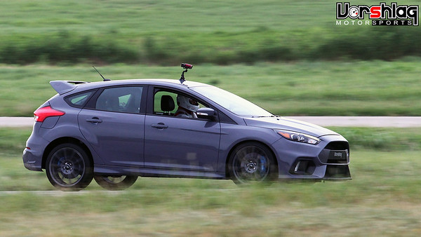

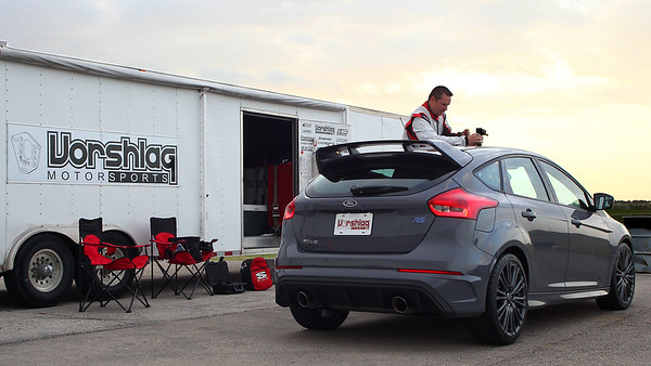

Brad and I trailered the Focus out to Motorsport Ranch on Friday morning July 15th, leaving my house at 5:30 am. We arrived at the track at 6:30 am, just after sun up, and started to unload. This was the first time in a long while where we got to run on a "member day" at MSR. There were close to 15-20 cars on track with me during the first 2 sessions of that morning, so there was a bit of traffic to deal with - but this also gave us a good gauge of how well the car was doing. Weather was mild but threatening rain, so we wanted to get a couple of sessions in and head out before we got soaked.
We mounted two video cameras, a microphone (still testing optimum placement - these videos still had too much wind noise), and one of our trusty AiM SOLO predictive lap timer/data loggers. I have used this exact AiM unit dozens of times at this track and it always reads within .1 seconds of the AMB transponder timing loop on a NASA race weekend. It isn't some free phone timing app with a slow GPS transponder - this has 3 accelerometers and a 10 Hz GPS. Sidebar - one of my friends used my other AiM and ran his cheesy phone timer app at this same event, and the phone "lap timer" was consistently 4 seconds a lap off!
Event Photo Gallery: https://vorshlag.smugmug.com/Racing-Events/Focus-RS-Test-MSR-071516/
Temps here in North Texas in late July can be oppressively hot, but we got lucky. With the first session on track starting at 7:30 am, ambient temps were only 79°F and overcast, so we were encouraged. We had high hopes for the RS and anticipated some good lap times. These are temps we normally don't see until Spring or Fall.

Reference times: My quickest lap time in a street legal car on the MSR 1.7 CCW course is a 1:17.25, which was set in 2014 in our NASA TT3 classed 2011 Mustang GT. My most recent NASA lap times back in March of 2016 were in my TTC classed 1992 Corvette (nearly bone stock in every way) with a 1:21.9 and a 1:27.6 in our TTD classed BMW E46 330. All of those times were on Hoosier DOT legal R-compound tires. The TTD lap time was a bit disappointing, though, because we still had the bone stock drivetrain (195 whp) and I made my best lap times on heavily corded 245mm Hoosier R7 DOT tires. That 1:27 lap was painfully slow but still good enough for the win.

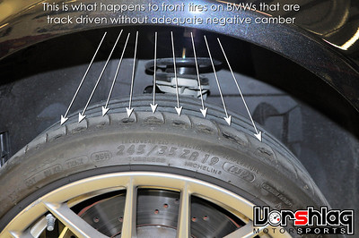

The 8 laps in the 7:30 am session on track were spent learning the car, navigating through traffic, listening to the front tires howl, and seeing the oil temps climb and climb. I came in after only 8 laps due to increasingly high oil temperatures (285°F was all I was willing to see in this brand new engine). Again, it was only 79°F ambient and I wasn't over-revving or drifting or anything unusual - I was pushing the car as hard as I would any other, not abusively. This first set of 8 laps were somewhat boring and I had a best of a 1:28.5, which is admittedly slow.

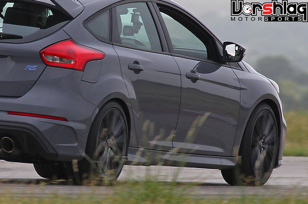

As you can see in the image above, the Focus suffered from a lot of body roll. It also was losing camber badly on the front wheels - the loaded front wheel in the picture above has probably 2 degrees positive camber, which is never good. With that positive camber shown in the image above it is no wonder that the outside half of the front tires were showing serious wear in only 8 laps on this super smooth, low tire degradation track surface.
Here is a picture of the car braking into T9, after the fastest straight on this course. As you can see, there was also a lot of brake dive. The springs appeared to be too soft to deal with even the moderate grip levels of the Michelin PSS. The brakes did feel pretty damned good - which was about the only thing I didn't complain about all day. With stock pads and fluid I wasn't able to ever boil fluid/lose pedal or fade the pads. If the grip level of the tires is upgraded we might have to re-assess the brake fluid and pad compound.
The tire and boost pressures would have been better at 500psi! ;)

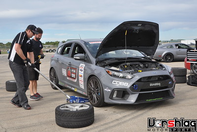

After these 8 laps (with 3 cool downs in there, so 5 hot laps) I came into the pits and Brad quickly used an IR gun to get a few temps... intercooler, brake rotors, radiator, etc. Nothing seemed extraordinary. The tires had crept up from 30 psi cold to 40 psi hot, which was about what we expected. We bled them down to 38 psi hot and kept them there for the next session, which was about an hour later.

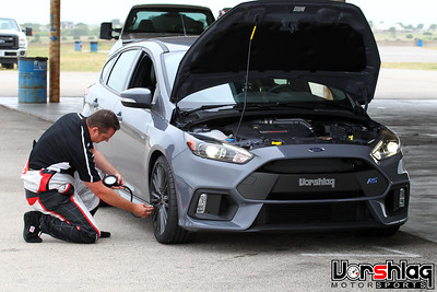

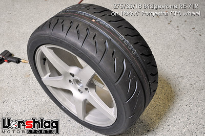

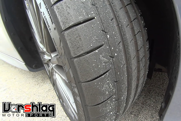

We had re-checked tire pressures to get them back to 40psi when hot, and this time set the car in "Track" mode. It was a bit crowded again but not so much that I couldn't get 3 hot laps without traffic, shown in the video below.
With as bad as the skies and forecast looked I was pushing to make this my fastest and last session of the day. It would either start to rain or just get so much hotter it wouldn't matter. Somehow it rained everywhere else in the metroplex but never did in Cresson.
The issue was the oil temps crept up rather quickly, and after 3 laps I had to alternate cool down laps with hot laps. After one cool down lap the oil temps would drop below 300F and I could make one more hot lap, then the oil was near 300F again. On the first lap the PSS tires have virtually no grip (when cold) but by lap 2 they were up to temp. The tires got hotter every lap and were starting to overheat and lose grip after about 5 or 6 laps.
In-car video from 3 laps in the 2nd session is here.
This overheating of oil and tires worked against me - I never got a clear lap of traffic in either session when both the tires and oil temps were both in their optimal zone. The predictive lap timer showed a possible "1:26.6" time on lap 5, but I caught a train of 6 cars going into the last turn (Big Bend) and had to back off considerably that time. The best lap I could put together was a 1:27.40 on lap 7, but I nearly matched that time with a 1:27.50 on lap 3 in this same session. Again - there was a little more in it, but I would have needed a completely clear track and a perfect drive when everything was up to temp.

The RS' 1:27 lap time nearly matched my times in a BMW E46 330 with 195 whp running at 3285 pounds back in March (with similar conditions). The BMW was indeed a bit lighter (3285 lbs in the BMW vs 3650 lbs in the RS, with driver), and much easier to drive at the limit. Both cars had equally excellent brakes, but the BMW had roughly 150 less hp. The 245mm tires on the BMW were a hair bigger and better compound, but were 8 weekends old, the compound was dead and the tread was badly corded.

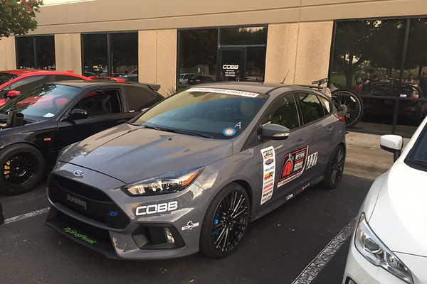

Todd Earsley (the RS's owner) has been competing in Optima events as long as I have, and has completed more Qualifiers and SEMA shoot-outs than almost anyone else I know. He has won his class many times, almost always podiums, and took his EVO 9 to as high as a 3rd place overall finish in Vegas at the big post-SEMA event.

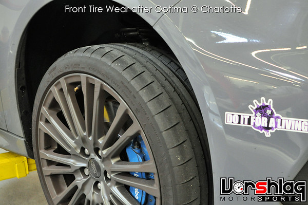

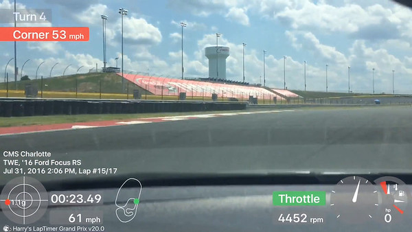

The results for GTS class are linked above. Todd said he fought with the handling (understeer), the launch control was buggy, and the oil temps were super high for him as well on track. He was even seeing high oil temps in the autocross portion, with 20+ minute waits between runs.
No changes had been made to the car yet, so it had the same brake dive and floppy OEM suspension as before. Todd remarked at how the Michelins were over-matched by the performance of the brakes (again, the best part of this car) but noted that the engine felt stronger than when he first drove it. Driving 1000+ miles to get to an event likely allowed the motor break-in period to be passed and the computer nannies unleashed all 350 horses.
He finished 8th out of 14 in class, so about mid-pack. Todd is an accomplished NASA TT and Optima competitor and I watched his in-car videos - he was pushing it to the limit, too. But for a bone stock car on absolutely the wrong tires, he did damned well. The hot tires in Optima competition are the Bridgestone RE71R and BFGoodrich Rival-S. Look for one of those on this car before the end of the season.
Todd's Charlotte Optima event highlight video
In the video above Todd narrates the in-car videos from his best autocross, speed stop and road course laps in the Focus RS. Great video, worth watching. He is a bit kinder than me in his opinions of the car, at least publicly, hehe. The understeer in the stock setup is apparent, but again, the brakes worked very well in all 3 segments. With better tires, some camber, and more spring rate it will surely improve.
Free RS Mod! We missed this one but while at the Charlotte event, Todd found a huge decal placed over about 1/4th of the face of the stock intercooler. We have speculated that this might be used there to block airflow, lower drag, and eek out a tick more gas mileage by Ford, but after more research we found Ford places it there to prevent water (during a high water crossing - which should never happen in this particular car) from entering the intake tract and possibly damage the engine. Todd removed this blockage and it uncorked a significant amount of surface area of the intercooler heat exchanger, which can now see airflow and "do work". Apparently this is the one "free mod" that people can do for $0 to reduce inlet air temperatures.

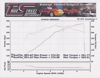

On his way down to the event he stopped in at COBB Tuning and they fitted the Focus with their Accessport and a Stage 1 tune, where it made 330 whp in an otherwise bone stock vehicle.
OPTIMA USCA COTA event results: https://clubregistration.net/clients/usca/results/overall.cfm?eventID=7059&class=GTS

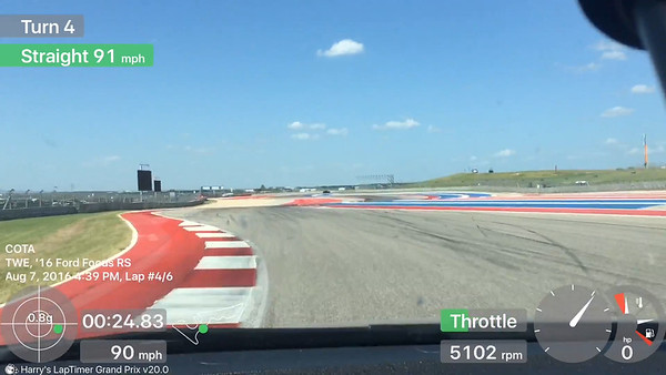

In the timed track event the RS had more grunt on the main straights with the added horsepower from COBB. The oil temperatures were even worse, however, and the 105°F ambient temps didn't help things. Drivers were overheating, cars were overheating, and the RS couldn't make more than 2 or 3 laps before he had to come in.
Todd drove well but managed only 11th out of 18 cars in the GTS class. If you look at the cars entered in this class it is some heavy hitters.... Mclarens, Corvette Z06s, and a 2016 Porsche GT3 RS was the overall winner. So he has a tough battle to fight in GTS with a bone stock Focus RS. Hopefully, with some smart mods, it can become a contender.

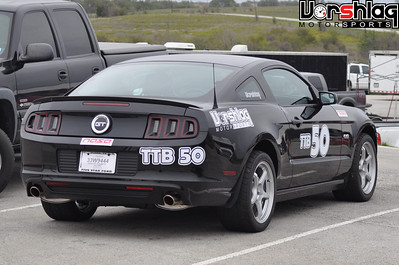

MOST NEW CARS HAVE SOME FAILINGS ON A ROAD COURSE, TOO
I wrote my posts from a very narrow point of view of track worthiness in stock vehicles. Most cars in showroom form have several flaws right out of the box that hold back their lap times and/or their on-track reliability, just like the RS. There are only a handful of sports cars built today that DO work well on track right out of the box: C7 Corvette Z51 (but not the supercharged Z06), Mustang GT Performance Pack (the base brakes can be killed quickly), and the Porsche GT3 to name a few.
I have a good example for this in a similarly priced car that I can share. One of the more track-able cars right out of the box when they were new were 6-speed Brembo packaged 2011-14 Mustang GTs (priced from $32-38K). We have done a lot of track testing in theses and of course they have their own unique track issues in stock form, that need to be fixed. In 2012 I bought a base model 2013 GT (for $25K new!) with the 420 hp 5.0L engine (which made 377 whp, shown above right) and the 6-speed trans. This car weighed very close to what the Focus RS did (3518 pounds, see above left). We purchased it without the optional Brembo brakes - it was a stripper model that was priced about what a Focus ST costs now.
This base model GT came with 235mm all season tires on 18x8" wheels. The the grip level of these tires with this power and weight was a complete joke (the Brembo equipped GTs came with 19x9" and 255 tires, which were a bit better but still too small). This 2013 had the base GT 13.2" front brakes (twin piston sliding caliper) and matching 11" single piston rear discs. To try to get a decent baseline "stock lap time" on the same set of wheels we had planned to use later, we installed a set of 18x10" wheels and 295/35/18 NT05 tires (2" wider wheels and 60mm wider tires, yet 6.8 pounds per corner lighter per corner). We also installed an AMB transponder, some class letter/number decals, and then I entered the car in a NASA Time Trial event at Eagles Canyon Raceway back in October 2012 for its very first track miles.
The car was a handful of days old, still had paper plates, and the stock brake pads were brand new and at full depth. I did one 15 minute TT session to get a feel for the car, and it seemed to be working OK as I increased my speeds. It did have a bit of understeer (lacked front camber, like nearly all cars in stock form) but it was manageable. In the second TT session I turned it up a bit and pushed my braking zones, running a string of three 2:07 laps in a row (which is fairly quick for a nearly stock car at ECR). The problem was the brakes...
On lap 7 of the 2nd track session, with an otherwise brand new car and brand new brakes, the front pads came apart. The material had worn so low that the remaining chunk of front pad disintegrated and essentially exploded as I braked after a 125 mph straight into a very tight corner (T7). There was no warning; the pedal just went right to the floor then I went for a ride about 150 yards off track. Not fun! I limped it back to the pits and all of the pad material was sitting inside the front wheels (see above left). The rear brake rotors on my wife's 2011 GT also "popped" that day - both rear rotors cracked clean in two! Granted, she was on race tires with full suspension and aero and running 1:56 lap times, putting more heat into the rear brakes. We later noticed that this rear rotor issue was a chronic failure and developed a 13.8" rear disc upgrade kit for these cars. On the black 2013 GT we soon upgraded the front brakes to the factory Brembos and that plus brake cooling, better fluid, lines, and better pads and it never had an issue with brakes again.
My point here is - MOST cars have some Achilles heel, some initial flaw that only comes to light when driven hard on a road course. In my last post I pointed out several issues we noted on the Focus RS, when driven how I drive any car on track. Mostly I was disappointed in the factory suspension design, the understeer heavy handling, tires that were too small for the weight and power, the computer controlled "RDU" rear axle that didn't do what it was supposed to do, the high oil temps, and the somewhat lackluster lap times. The track performance we saw first hand just didn't seem to live up to hype and real world costs for these cars ($45K is a common price I see for a lot of RS cars), in my view. It had more issues than most, but I doubt it has anything we cannot "fix".

Also, the RS wasn't all bad. I did say that the RS comes with great brakes, but I neglected to mention that it also has really good ABS programming as well - at least with the 300 treadwear tires we have used on it so far. Ford seems to do a much better job than most companies with their ABS programming scheme. So many other modern cars have somewhat lackluster ABS functionality (I'm looking at you, GM). I cannot overemphasize how well these brakes worked on stock pads and stock fluid. Normally I can ruin brand new factory brake pads and boil brake fluid in a session or two (my 2013 Mustang GT example above is not unique) but not this RS. The brakes were "Fair Proof", heh.
The factory clutch also seems to be holding up well. Todd mentioned this in his Optima @ COTA overview video (the tail end of my last post), as he has now done dozens of "launch control" standing start launches. The AWD functionality seems to work fairly well from a stop. AWD is very important for Speed Stop and Autocross runs in Optima, where those two competitions and their specific course layouts tend to heavily bias AWD cars' launching performance. The image above showed the time slips autocross and speed stop runs he did in one day - a testament to the durability of the RS clutch system.
Todd did say that the complicated steps you have to go through to engage the launch control were hard to do via the stalk mounted controls with gloves on. If you moved the car one inch you had to go through this multi-step process again. A little clumsy, but he is working with COBB to see if he can make that easier to engage (like the factory EVO launch control).
Again, we feel that our criticisms were well earned by the RS. The rear diff did not work right when I track it. The tires were too small. The suspension is sloppy and needs help. In the sections below I will try to explain in more detail what is needed and why. I will even explain why we used the tire pressures we used - because several folks questioned even that.

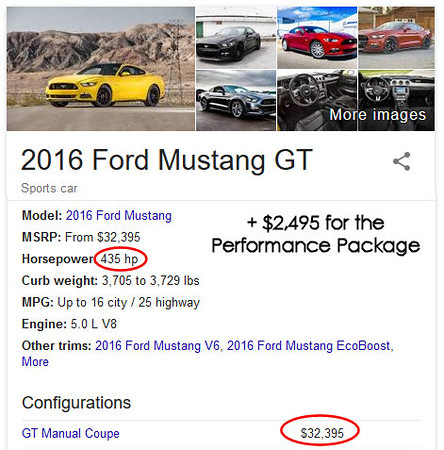

"THERE IS NOTHING ELSE FASTER IN THIS PRICE RANGE!"

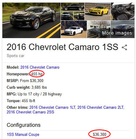

This is another claim many have made - that the $37-45K priced "RS is the fastest car available for the money". Of course that is very debatable, and when presented with other 2016 model cars that cost the same or less and DO go faster around a road course (see two below), the qualifiers come in.... well, "I live at the North Pole and I need AWD for driving in the snow". Or, "I need a back seat with 4 doors to haul my dogs". And on and on.
We get it - these two pony cars are in a completely different market segment than an AWD hot hatch
There are several choices in this price range that have faster lap times in stock form. But what about similar "hot hatches"? I mentioned several 4 door AWD competitors in my first 2 posts. Sure, that is the one thing I could have done differently, if we had the time and resources at our first MSR test day - I would have track tested some other hatch back turbo 4 door cars that day. This would be a logistical nightmare, but I will try to track down a few of the RS' competitors and wheel them around MSR under similar conditions on their OEM rubber. I am reaching out to some of our customers with similar turbo AWD or even FWD "hot hatches" to see if we can put them to the test at MSR and compare lap times. Because, in the end, the lap times are what matter most to me. How the car deals with the heat of road course abuse (cooling, brakes, and tires) could also be compared with these cars, too.
WHY TIRE PRESSURES ARE CRITICAL - AND IMPOSSIBLE TO ADVISE
One of the many things people have questioned about our initial track test in the Focus RS (and the list is long!) was the tire pressure we chose to begin the testing with. And the basis for their reasoning I have seen posted is all wrong. Let me explain.
Left: Do not count on this sticker for track pressures! That is for MAX LOADING ONLY
To get to the initial tire pressure settings we started with, we looked at the recommended tire pressure decal on the door frame, shown in this video. The numbers that Ford publishes are 46 psi, which are laughably high. These are actually there to prevent people from running their cars fully loaded at the rated gross vehicle weight limits on nearly flat tires - remember the Explorer/Firestone tire fiasco? The 46 psi numbers are the highest pressures they recommend when the RS is FULLY LOADED TO MAX CAPACITY - with 5 people, a tank full of fuel, and the hatch area full of luggage. But these numbers are not for normal street driving and definitely NOT FOR TRACK DRIVING.
We noted that this car had 60 psi in all 4 tires as delivered from the Ford dealer, which was part of the reason why it rode so poorly in our initial street driving tests. This was a mistake on somebody's part - no sane person would run 60 psi on these MPSS tires for any sort of use. This particular RS likely had a porter or tech that performed a sloppy "make ready" service at the Ford dealership, and I suspect they should have lowered the pressures when this car came off the transporter down to a more reasonable 35 psi for regular street use.
Instead of of the "recommended for max load" 46 psi number, we started by setting all 4 tires to 30 psi cold (the car was trailered to our first MSR track test, as shown below, so the tires had no heat in) and we were hoping to see 40 psi hot on the front tires after coming in from hot laps (they did). The rear tires do so little work on this Focus that the pressures back there don't matter as much, but we still started with 30 psi cold and they got up to 38 psi hot, too.
This was an educated guess learned from nearly 30 years of tracking cars, testing tires, and building suspensions systems. We test a lot and have learned some good starting points for a variety of tires on a wide selection of cars - and more importantly what to look for to adjust pressures after they are up to temp to try to find ideal settings. Cold settings don't mean much, what we are concerned with is HOT tire pressures.
We always adjust the hot pressures AFTER the first track session, where we also inspect the tires for shoulder scrub. If we noted the "tire scrub" line rolling down onto the shoulder, below the tread cap, we would add more pressure. If the scrub line was higher, and didn't use 100% of the tread blocks, we would lower the pressure to use more of the tire's working tread area.
Short video
showing outside tire wear on Focus after first 8 laps
As you can see in the video above, which was taken with 83 street miles and only 8 laps on track at MSR (after my first track session), front tire wear was visible yet the rear tires almost had no wear. Most of the front tire wear was on the outer 3 tread blocks, yet the outer shoulder scrub line looked good. From that we knew we were pretty darn close on the tire pressures for the 235mm Michelin PSS, yet we had a long way to go to get this car to go faster on track (see suspension discussion, below).
continued below

Front tire wear after 83 street miles and 16 laps at MSR-C
This image above shows the total tire wear after our initial 16 lap track outing (two 8 lap sessions on a track surface with very low tire degradation), and the image below is after 2500 street miles 2 days of Todd racing at the Optima event. Overall the tires are wearing somewhat heavily BUT that's mostly due to the stock suspension losing so much camber in roll and too narrow of a tire for this car's weight. Overall this is about as good as we could expect for front tire wear on a 59% front heavy, effectively FWD, overtaxed and narrow tire that is losing 2-3 deg of camber when rolling in a corner.
Worn pretty poorly after 2 events but as good as we would expect considering the weight/size/suspension

CAMBER SETTINGS MATTER AS MUCH OR MORE THAN PRESSURES
Track pictures make good data. This image is useful to tell us about camber settings, tire pressures and roll.
Tire pressures and camber settings are two of the most crucial settings a racer can alter to make the tires work more effectively, so we take these settings very seriously - we have to. We can only do so much with tire pressure changes, but a camber setting can make an even bigger improvement to tire performance and wear.
The ideal front camber setting for a modern radial tire will still have some visible negative camber when loaded fully in a corner. The Focus goes to about +2° positive camber under load, which is bad for both tire wear and ultimate grip - a significant portion of the loaded front tire isn't touching the ground. It is not "doing work".
Vorshlag is a multi-faceted business, but our primarily focus is to design and build suspension components to improve factory built cars for road course use. As suspension engineers and designers, our main goal when creating suspension components is simple: make the tires work more effectively. Everything we do with dampers, spring rates, adjustable camber plates, wheel widths, even chassis construction is done to optimize the tires when being driven on a road course or autocross conditions.
These 4 small contact patches of tire are the ONLY things connecting the car to the track surface, and we do everything we do to maximize the size of the contact patch (camber + tire pressure), and to make sure it isn't in the air (dampers + springs). "Tires in the air do no work" is a saying I use a lot, and if you look at slo-mo video of cars with poor dampers, the tires are not on the ground as much as you might think while cornering over even small track imperfects.
If you think about the pinnacle of motorsport - Formula1 race cars - they still use a LOT of static negative camber on their front wheels, which is visible in this Redbull F1 car above. Why is that? Don't these cars have the ultimate in suspension design? Ultra rigid carbon fiber control arms and carbon tubs that have zero deflection, metal suspension bushings that don't deflect? Double A-arm geometries that don't lose camber like a McPherson strut car does in roll? Super stiff spring rates, and THREE swaybars (front, rear, and FRIC) to control roll and heave? Yes, they have all of those things, and yet they still run -4° front camber, and on tighter street courses they run even more (Monaco). So it isn't unheard of for your Focus RS to need a lot more than the -1° it comes with from the factory. If we had the room we'd run the RS at -2.5 to -3° front camber on the otherwise stock suspension and tires.
On top of that, this RS is losing a lot of camber from roll and deflection (see below). One of the major problems we see in ALL late model, McPherson strut front suspension cars is a lack of camber control when loaded laterally in hard cornering. The front suspension bushings deflect and the soft springs roll so much that the car gets into a excessive roll condition. This makes the loaded outside tires start to roll off the ideal "flat" contact patch and onto the tire's shoulder.
This is not a tire/wheel position you ever want to see when cornering

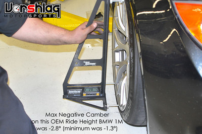

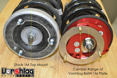

Even the $50K+ BMW 1M was very front camber limited in stock form - this tire damage happened in one HPDE weekend!
Changing to coilovers, quadrupling spring rates, and going to camber plates is a pretty drastic change just to keep the tire from shredding itself in a corner. Sometimes, like on this BMW 1M model (above and below), we can keep the stock sized tire from getting shredded on the outer shoulders just by adding a spherical top mount camber plate. We had enough room in the strut tower with the OEM springs/struts on these E82/E90 M models to do just that.
We fixed the 1M with camber-caster plates - more from negative camber dealt with the tire wear easily
These 1M could see as much as -1.7° camber in stock form, but that still wasn't enough when you factored in the rubber top mount deflection, soft springs, and associated body roll. The damage to the tires shown above was from 2 days on track at a normal HPDE weekend, when driven by an experienced road racer pushing the car 10/10ths. With our spherical camber plates the camber adjustment went to over -2.8° while keeping the stock springs (they can get more camber with smaller diameter coilover springs). This small change - just one degree more negative camber and less deflection from changing out the rubber strut top mount - allowed this 1M and many more to stop killing front tires in one weekend.
We have do this "camber fix" on dozens of McStrut cars and hoped to do the same on the Focus. As my Focus Suspension Challenges video from last time showed, there is just not enough room to move the OEM front spring inboard before it hits the tower, so we have to change to coilover springs and new struts to allow for this much needed camber adjustment. That happens this week!
TIRE WIDTH PER UNIT WEIGHT RATIO
Another factor (other than the soft suspension) that is hurting the Focus on track, for both ultimate grip and especially long term tire wear, is the relatively narrow tire it comes with. The 235mm tire coupled with the 3450 pound as tested weight makes for a difficult "tire width per unit weight" ratio for the RS to overcome - and is another item we will address to try to lower lap times on this car. So many magazine writers fixate on power-to-weight ratios, but almost nobody ever talks about tire-width-to-weight ratios. Which, for handling, is so much more important than power!
Jarrett Jan's 2235 pound Miata on 225mm tires has more equivalent tire than our 3600 pound Mustang on 335mm tires?!
Some friends and I that autocrossed back in the 1980s-90s figured this out early on. We used to keep track of weights and tire widths use when comparing autocross times - because it was alarming how well CRX and Miata models did on slower courses on their "smaller tires" compared to more more powerful yet heavier cars we tended to race with. The truth was that these little/light cars had a HUGE tire-per-unit-weight advantage. Here's a quick calculation for the 2 cars above: a 2250 pound NA Miata on a 225 tire would equate to a 3600 pound Mustang needing a 362mm of tire for an equivalent weight to tire width! Even with the 335mm tires we ran at Optima events (above right) we were at a distinct disadvantage to this Miata on the same model and compound 225mm tire.
Let's do a comparison that isn't fair, yet is still valid. A C6Z06 Corvette with 505 hp weighs 3217 in this version (2012 model with factory optional 20" wheels). This is a big car, with 51%F/49%R weight bias has OEM 335mm width tires on a 20x12" rear wheel (which weighs 8 pounds more than the Focus 19x8" wheel and 235mm tire). This is the rear drive wheels so they are critical on track. The Focus at 3445 pounds on a 235mm tire is at a huge tire-per-unit-weight ratio disadvantage.
To have an equivalent tire as the C6 Z06, the Focus RS would need to to be running a 358mm wide tire. Of course there are other variables at play, and the AWD system of the Focus should close some of that "tire advantage" gap in slow speed corners (autocross), but as we've seen the AWD advantage has almost no effect on a proper road course - unless it is raining, there are VERY slow corners, or the Focus gained another ~200 whp. Once you get off the super narrow OEM tires, we have found that AWD doesn't do almost anything on a lower powered car above certain speeds.

THE "FAIR" FOCUS RS TO EVO X COMPARISON
Bone stock 2008 Mitsubishi EVO X MR - with sticker power!
I want to get back to the EVO X for a minute - a car I compared the Focus RS to in my first two posts in this thread. This was a car that was very similar to the Focus RS in many ways, which we worked with over 2 years and made much better, and won a lot of autocross and time trial events in - a 2008 EVO X MR. It also had a few notable differences, but overall they were more similar than not.
Left: Inverted monotube Bilsteins on the MR were better, but springs were too soft. Right: Factory 18x8.5" and 245mm tire = 46.8 pounds
The EVO X was a $35,000, relatively heavy 4 door AWD car with a front weight bias - all similar to the RS. It has a turbo and intercooled 2.0L engine, beefy Brembo brakes (with 2-piece rotors), factory launch control (really a 2 step rev limiter, just like the RS), and rode on relatively soft stock suspension. The MR came with a slightly better shocks (inverted Bilstein struts, which have less strut deflection when loaded than a twin tube strut), the dual sequential transaxle (so nice, when it worked), and a more sophisticated rear suspension. It had a 245mm tire on a 18x8.5" wheel, so a very similar stock tire-to-weight ratio to the RS. It made 300 hp in stock form but with exhaust changes and a tune we got it to over 380 whp, which some are already able to get to in a modified RS.
I went back and read our EVO X development thread and I noted that we wrote that it suffered from similar "stock suspension" challenges, which are visible in the track and autocross images shown when raced it on the stock suspension, after initially upgrading to a slightly more competitive 245mm Dunlop tire on the stock 18x8.5" wheels. The car had a TON of body roll, front camber loss, and brake dive in this "stock suspension" autocross I raced it in, shown above. About the same as the Focus has, in all fairness.
In stock form it was pretty terrible, so maybe I was too harsh on the RS? If so, here is my apology to Ford and the RS' fans... the EVO X was equally as crappy as the RS. ;) It just seemed like the RS had so much positive press and hype you'd think it was a space ship - but the EVO X was treated much the same way by car mags and forum fan boys alike.
We didn't keep the EVO X on the stock suspension very long, and after one autocross and one NASA Time Trial it got coilovers and camber plates. I was just remembering how much better it was the majority of the time we used this car over 2 seasons - with properly upgraded suspension.
continued below
Vorshlag-Fair
Official Site Vendor
Nov 12, 2010
1,592
116
Dallas, TX
continued from above

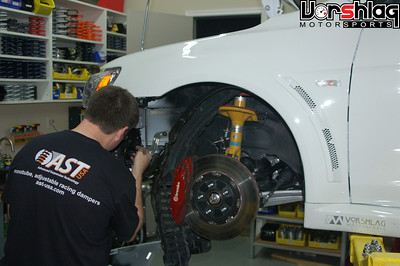

Left: Enkei 18x10.5" wheel and 275/35/18 Yokohama was 48.5 pounds. Right: This big tire and wheel lowered lap times on the EVO!
The first things we did were add proper monotube coilover dampers, upped the spring rate, and lots more negative camber to the front end - which is the same order of mods we have planned for the RS. We then upgraded the wheels to wider 18x10.5" wide Enkeis with 275mm wide good street tires (Yokohama Advan AD07). Again, similar in tire width (275) and wheel width (9.5" or 10") we have planned for the RS. I don't think the RS can fit as much wheel as the EVO X, but we'll soon see after the coilovers are installed.
With monotube coilovers, more spring rate, swaybars, camber plates, and wider wheels/tires - this EVO X cornered flatter and was much faster
Like we have planned on the RS, we focused our changes on the EVO X on the same basic suspension upgrades - minimize body roll, reduce suspension bushing deflection, add negative camber, improve dampers and up the spring rates dramatically. Then we added wheel and tire width to improve mechanical grip.
This EVO X MR also had a major flaw on track - we had to quickly make some cooling upgrades the MR's transmission cooler. The Getrag DSG semi-automatic trans ran hot on track (after 10-12 minutes it would overtemp the trans and go into limp mode) until we opened up the front cooling duct and added a fan. Like the oddly placed intercooler decal covering 1/4 of the front heat exchanger on the RS, the MR had a large transmission fluid cooler that was 1/2 covered up by a foglight. We removed the fog light, meshed the now larger openings (to keep rocks/bugs/klag from packing up the heat exchanger), and then added a 5" electric cooling fan to use in the pits between sessions to cool this fluid. Cured the over-temp issue and allowed the EVO to run complete 20 minute track sessions without fail.
So looking back on it, the EVO X MR we raced for 2 years was far from perfect in stock form. With some work, a lot of testing, some upgraded components, and the help of others we were able to make it more reliable and much faster. Hopefully we can do the same with the RS. COBB did the tuning on our shop EVO X and they have already tuned Todd's Focus RS as well. Evolution Dynamics also has some tricks up their sleeve, as do other partner shops that are working on this car. It looks like we might just be able to cure what ails the RS. Stay tuned!

We have used many sets of Michelin PSS tires on many cars on track, as well as dozens of other brands and models, what we have learned is - there is no magic tire pressure to run on all cars, even tires of the same model/brand. There are so many variables that affect tire pressure, it would fill a book.
Tracking with 245mm wide MPSS tires at ECR on BRZ
For example: on this lightweight (2775 pounds) rear wheel drive Subaru BRZ above was run on a 245mm MPSS for both street and track use on a 17x9" wheel (we later moved up to 255mm BFG Rival tires). After track testing we ended up with around 32 psi hot tire pressures on the MPSS. These lower pressures can work better on lighter cars and/or cars with a better tire-width-to-weight ratio. We had really good suspension (MCS 2 way coilovers) and excellent camber (Vorshlag plates) and good swaybars on this BRZ, too. It cornered flat, had plenty of static negative camber, and a well supported tire of proper width for the weight and power - so it treated the tires well. This car with this tire had a similar weight-to-tire-width ratio to most Corvettes.
Left: 215 vs 245mm tires. Right: The FR-S/BRZ's main weakness in stock form were the craptasitc, skinny tires they came fitted with
Funny thing is - we made a big deal about how TERRIBLE the factory tires were on the BRZ and FR-S. I gave that car more grief than I did the RS. Of course at the time, this was scandalous - "Why do the magazine writers rave about this car if the tires are so bad??", they said. There were fan boys of this car as well, but the fact was that the skinny 215mm "Prius" tires they fitted to the 86 twins were a joke. Over time many thousands of BRZ/FR-S owners have upgraded to better 245-255 mm tires, which we recommended from day 1.
Toyota and Subaru missed a number of things on the 86 chassis design, which I was just as vocal about in that project build thread. The ridiculously wide FA20 2.0L engine makes underwhelming amounts of power for this car. The engine is placed about a foot farther forward in the engine bay than needed, which helped contribute to the relatively poor 56% front weight bias - pretty awful for a RWD car.
Overall the 86 twins are still nice handling cars due to two important facts: they weighed in staggering 670 pound lighter than the RS, and the track width is very wide for a car this light. Granted, the RS can likely eat this BRZ's lunch on a road course in stock form, especially with the little Pruis tires the factory fitted. By the time we were done this BRZ, however, it was an autocross and track terror with zero power mods. I ran laps as fast as the 420 hp 2013 Mustang GT at ECR (2:07s) in the 200 hp BRZ.
Honestly the "86 twins" are cars that people should also look at if they want to have fun on track or autocross. Yes, even versus the Focus RS. That seems crazy - it has 150 less hp and 2 fewer drive wheels - but this comparison can be made simply because the chassis is so much lighter. It has a decent suspension setup, lower center of gravity, decent RWD Torsen differential (no robots, computers, or NASA scientists needed) and again... it is 670 pounds lighter than an RS.

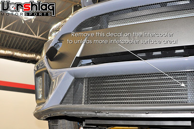

After pulling the engine undertray and front end off we have great "underskirt" pictures of the RS in new areas. Look for those in my next post.
With the front end off we are measuring for placement of a large external liquid-to-air oil cooler. We're going to try to fix that issue before the next track test and road course event. More partners have come on board with upgraded parts, after seeing this form thread and noting Todd's and our track testing. Lots of new parts will be installed in the next 2 weeks. Which is good, since Todd is running the RS at the 2 day Optima @ Road America competition Aug 27-28th. We are hopefully going to be track testing the new suspension, exhaust and oil cooler before he leaves, so we have a tight deadline.

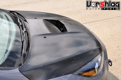

Todd's test mule RS also got a pre-production oil cooler, two vented hoods, better brake pads and many more parts. This Focus was raced in many Optima events, competed in the GTA Super Lap Battle, and was even shown in a booth at SEMA 2016. Since my July 2016 test laps in the RS at MSR I've been back for 13 more tests at this same track in a variety of cars, so we have some good data to compare against. At the end I've added 4 Optima event videos the RS' owner Todd made, which are excellent. We have almost 10 months of stuff to cover so let's get to it.

We knew immediately after our track test that the Focus needed a lot of help with the suspension - the much touted adjustable shocks were nothing special: just ordinary twin tube shocks with some small range of damping adjustment.
The main issue was that the spring rates (and swaybars) were super soft and letting the top heavy/front heavy chassis roll too much in turns. This puts the wheels into positive camber under load, which shreds the outside of the tires and reduces grip substantially. Instead of just complaining about the problems, we developed a multifaceted solution.
As I've noted in our previous posts and videos about the 3rd gen Focus suspension, there were some serious challenges to making an adjustable front camber plate that would allow for any negative camber adjustment. There was simply nowhere for the large diameter OEM spring to go inside the strut tower - a geometric limitation we couldn't fix while keeping the stock style springs. The giant formed "lip" shaped around the stock strut top mount also really tied out hands, as making something tall enough to slide under that lip would raise the car a half inch or more. We really need to slide the top of the strut assembly inboard about 3/4" to make a measurable difference in negative camber travel, and this big car needs a LOT of camber help.

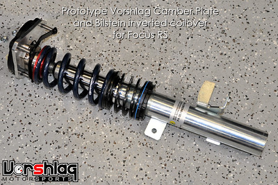

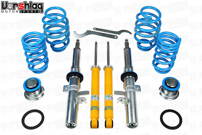

Again, a spring rate increase was needed. The only real way to make meaningful spring rate increases are to switch to coilovers - which gives us nearly an infinite number of lengths and rates to choose from. The smaller diameter coilover spring would fit better within the confines of the strut tower, allowing for camber adjustment.
Going to coilovers and higher spring rates would trigger a need for better dampers, with a more robust monotube style being key. After taking a lot of measurements we found one monotube coilover option available in 2016 - something not listed for the RS but one which we felt we could adapt. The inverted Bilstein PSS kit above was purchased, and we got to work on the camber plate design right after our first track test.

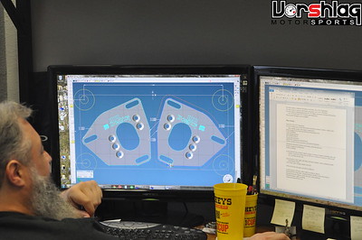

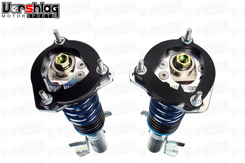

Making the prototype set of camber plates was next. Due to the goofy flange that stuck down under the strut tower we had to make the top of the camber plate assembly (a piece we call the "top ring" or "pointer ring") thicker than normal. We pushed forward with a "coilover only" camber plate version, as we honestly felt anyone with an RS that was serious about track use would jettison the factory shocks and springs quickly.
There was a lot of running around to make these happen in a very short amount of time which I am glossing over. CAD design, CAM programming, CNC machining the camber plate parts (in-house), CNC plasma cutting the top rings and bolt rings (on Todd's own machine) hand fabricating bolt rings, etc. We rated the springs that came with the Bilstein PSS kit and they were still too soft, so we sourced Hyperco 60mm coilover springs in much higher rates. This prototype set of camber-caster adjustable plates were assembled with the Hyperco springs, our tender springs, and the Bilstein PSS coilover front struts.
Violà! Massive improvement up front. The smaller diameter springs left plenty of room to move the strut inboard, the camber plates allowed this much needed adjustment, and the thicker "top pointer ring" let the camber plates slide under the raised lip of the bottom of the strut tower. Normally this top ring (shown in black above) is .100 to .250" thick, but in this case it needed to be .500" thick to clear the formed flange under the strut tower. For the prototypes we used two stacked .250" steel top rings, but for the production version we made them out of .500" aluminum.
A trick we do all the time was employed here - convert a Bilstein PSS series coilover to 60mm Id springs, which allows us to customize the spring rate. Lots of these PSS kits come with a weird "tapered" spring: 60mm ID at the bottom and blooms up to the large OEM size at the top - made to work with the factory upper spring perch and top mount. We replace the upper perch with one from our camber plate kit and add a 60mm main spring + tender spring to fill in the gap.
If you look at the above right picture you might notice that we the installed strut/spring/top mount with more negative camber and more positive caster. As you can see the top of the strut pin slides under the small raised section of the strut tower for much more camber & caster travel than than we would normally see.

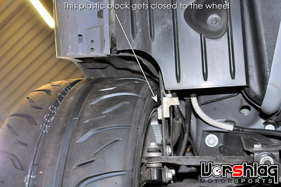

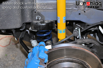

Out back we pulled the soft, tall, large diameter OEM springs and tried to install the rear ride height adjusters that came in the PSS kit. We had to modify those to fit the RS rear suspension mounting. We will make a production ride height adjuster to work with the RS for these kits plus coilovers from MCS and other brands.
With the ride height adjusters modified we were finally able to install the 60mm Hyperco rear springs that matched the front rates. The non-adjustable monotube rear dampers from the PSS kit were bolted in without any issue.
Above is with ride heights set. It looks low but that's because the stock ride heights are fairly tall. With the new, shorter Bilstein shocks on the car we started the setup with shock stroke numbers of 3/5ths bump & 2/5ths rebound travel. This is the safest starting point for a given shock length. With the suspension installed and some added camber dialed in we could measure for wider wheels. We noted that a 9.5" wide wheel would fit with the lowered and cambered setup, so we immediately ordered 18x9.5" F14 wheels from Forgestar. They showed up raw in about 7 weeks, which is pretty fast for them to make custom wheels.
Without time to track test the new suspension we set camber somewhat conservatively at -3.0° up front and -1.3° rear (we later increased the front camber setting to -3.5°, and there is more camber plate travel to go). We maxed out the added positive caster and still had plenty of negative camber travel. Todd had an Optima event he had to leave for immediately so we sent him out the door with the new Bilstein coilover shocks, firmer spring rates and new camber/caster settings but still with the stock wheels and tires. The wheels took a long time to get so he ended up doing 4 more events on the factory 235mm MPSS tires and heavy 19x8" wheels.
MISHIMOTO OIL COOLER + THROTTLE PEDAL SPACER

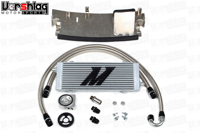

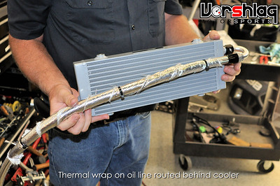

During one of the checkups we were performing on Todd's RS, we removed the front end so we could investigate where to place a large external oil cooler. The car had been dealing with high oil temps in both our tests as well as the Optima events Todd was entering. After a COBB Accessport was added the digital readout of oil temp was monitored closely, and it was very hot (over 280°F) when driven on track, even with bone stock power levels.
We had planned on using a large Setrab cooler but it would take a lot of modification of the factory radiator shroud plastics to make it fit. The pictures with the front bumper of the RS was seen by the folks at Mishimoto and they reached out to us about an oil cooler they had designed - which they needed tested on a track driven RS. Since Todd's RS was one of the first being run in competition (with Optima) on a road course, this worked out perfectly.
After Todd came back from another Optima event (after we had installed the suspension) the Mishimoto bits arrived. The prototype kit was well appointed and came with the heat exchanger, pre-made braided oil lines, mounting brackets, and an oil filter sandwich plate take-off / thermostatic bypass. It also had the fabricated aluminum shroud shown above with an integrated air scoop to better feed the stock airbox. We got the second prototype and tweaked a few things and shared that with Mishi engineers before they put this kit into production.
Due to extreme packaging constraints the return oil line passed behind the heat exchanger, so we thermal shielded the braided line to keep it from getting re-heated. The kit installed cleanly and was a lot easier (and less costly) than the massive unit we had planned - which would have required a lot of custom changes to the OEM parts that we couldn't easily un-do.
The oil cooler fits above the bumper beam behind the upper grill, and doesn't block any airflow to the intercooler. Since we drained the oil for this install we went back with Motul 5W50 Ester based synthetic oil. This is a really good oil that bridges the gap from their street car 8100 synthetic oils to their full ester based 300V racing oil. We use this 5W50 Motul in high powered and turbocharged cars that see heavy track use in high heat environments. The oil cooler install + oil change took 4.24 hours, including removing and reinstalling the front bumper and all of the plastics.

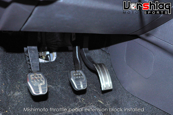

Mishimoto also sent us this throttle pedal extension block, which we installed behind the factory drive-by-wire throttle pedal at the firewall. The idea is that the gas pedal will be too low relative to the brake pedal when you are doing heel-toe downshifts on track. I didn't notice this during the baseline track tests but I've driven some janky cars with wacky pedal setups, and it doesn't seem to be something that bothers me. It might be a huge improvement - I've driven the car since and forgot to even think about this change. This took .69 hours to remove the stock pedal, install the extension block, and reinstall the pedal assembly.

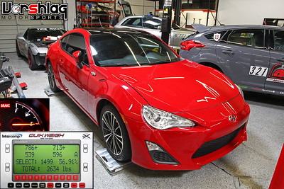

TALKING ABOUT CURB WEIGHTS = I BOUGHT ANOTHER CAR
In my previous post about the Focus RS here in August 2016, I showed the weight of a stock BRZ weight at 2775 pounds, and noted that it had 56% front weight bias - which is unusually front heavy for a RWD car. Seeing this BRZ weight reminded me how much fun lightweight cars can be, then some other factors about our V8 swap kit for the 86 chassis popped up that made me think about buying an "86" chassis again (BRZ/FR-S/GT86). Later in August 2016 we bought a 2013 Scion FR-S for a great price, and started documenting the progress in an existing FRS/BRZ development thread. And damn if this FR-S wasn't another 140 pounds lighter than the BRZ we weighed back in 2013...
Compared to the 3445 pound weight of the RS, this 2634 pound FR-S was 811 pounds lighter - that's a huge amount. We did some basic repairs to this used FR-S, got it back into showroom stock shape, even installed stock sized 215mm tires with 320 treadwear to be as close to the stock junk that came on these cars.
I'm showing this for a reason: we took the little FR-S to the same test track (MSR-C 1.7 CCW) to get some baseline bone stock laps, which shows several things.
First, even at 811 pounds lighter race weight than the RS, the FR-S was slower on track by about 4.5 seconds (1:27.4 vs 1:31.9) in stock vs stock form. We tested the FR-S in very similar conditions and of course with the same hack driver (me). The FR-S handled much better (beautifully neutral) in stock form but the lack of power was very apparent. 200 hp vs 300 hp makes for a 50% bump from the FR-S to the RS, which is hard to ignore, even with the weight difference.
FRS: 2634 pound curb weight + 200 pound driver / 200 hp = 14.17 pounds per hp.
RS: 3644 + 200 pounds / 300 hp = 12.15 pounds per hp.
As I say all the time, on a road course there are two key ratios: power-to-weight and tire-to-weight. The p-to-w differences shown above don't seem like much but 2 points here is typical of the difference between one full class jump in NASA Time Trial. We wanted to track test some theories on this FR-S which might be applied to the RS later. One of those was adding a Big Brake Kit upgrade for the front of the FR-S, and the other was adding only front camber.
Even with somewhat "neutral handling" the front tires were still rolling over on track and chunking the outer shoulders of the 215mm tires with the stock camber (-0.8 deg). On this 86 - like most chassis - we were able to make a camber plate that works with the OEM springs, which made for a -2.9° front camber setting at stock ride height (we tracked it at -2.5°). The big brake upgrade seemed unnecessary, because even with AutoZone brake pads the FR-S' stock brakes seemed bullet proof on track, but I was wrong - this upgrade helped drop lap times. There is no substitute for Motorsport level brake calipers and rotors.

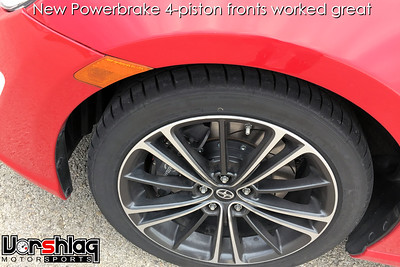

A retest later showed that the added negative camber + BBK, but still on junk tires, netted a 2.3 second drop, getting down to 1:29.6 laps at MSR-C. That time matches what I ran in the RS when in the normal driving mode back in our baseline Focus track testing. So it was catching up...

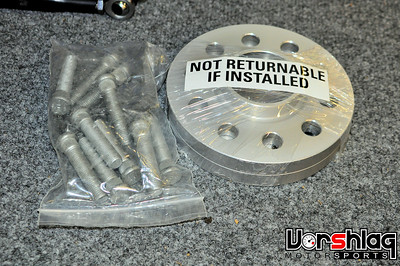

WHEEL SPACERS, LONG WHEEL STUDS, AND BIG WHEEL UPGRADE
We had designed the 18x9.5" wheel to be rotatable front to rear, to keep the tire wear even. To do this we needed a 15mm spacer installed up front. We ordered these hubcentric spacers from H&R, shown below.

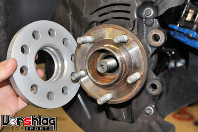

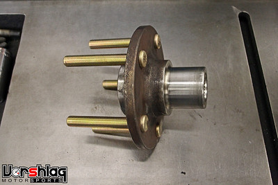

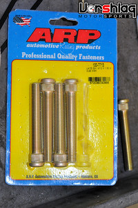

We knew the stock studs would be too short, but I'm showing this to prove why.

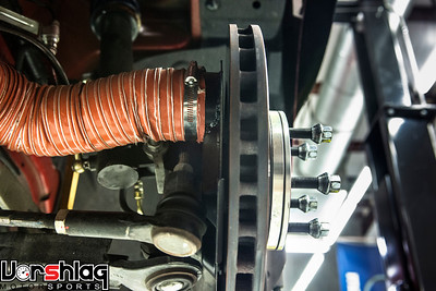

These spacers came with studs but they looked a bit short, so we ordered some ARP wheel studs (for another application - that took some research) that were a fully 3" long. To install these we needed to remove the front hubs...

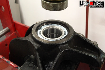

The retaining nut was removed then we tried to pull the hub off on the car. Nope. Then the spindle was removed and inspected - looking for a snap ring to retain the bearing. Turns out that retaining ring that holds the front wheel bearing inside the spindle is impossible to remove once the hub is installed (there is no access). One of my technicians fought with this for a while and finally had to break the bearing on the 20 ton hydraulic press to get the hubs out. We ordered replacement name brand bearings and snap rings from a local supplier that had the right part number in stock that day - we were short on time before Todd's next event.
With the new bearing and snap ring installed into the spindle, the hub had the ARP wheel studs pressed in and then the hub was pressed into the bearing. Once the hub was on again, the snap ring becomes inaccessible. PRO TIP: only buy front wheel bearings from the Ford dealer! About a week after this wheel stud install both front wheel bearings started to fail... made noises, got louder, had to be replaced. The Ford bearings take longer to get and costs more, but they last.
With the ARP studs installed now we had more than enough length past the 15mm spacer to engage the lug nuts.

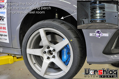

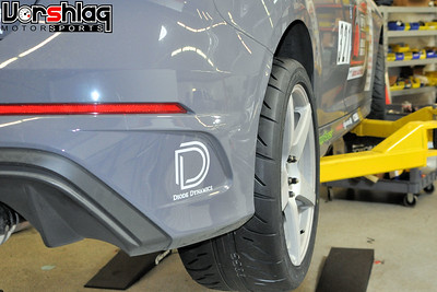

The tires arrived right as the wheels did, we mounted them on the raw aluminum wheels, and got them on the car.
The image above shows one of our "secrets" to stuffing wide wheels under a car - keeping as much wheel "inboard" as possible, as close to the strut as possible, by getting the spring package "Above the tire". This worked out perfectly, but took calculations for spring and tire heights and rates.
With the tires mounted they were driven around the block to check for rub. As the picture above shows there was a plastic wear block that got close to the rear tires but it proved to not be an issue.
Now we had upgraded suspension and big grippy tires. Track test!
SCCA TRACK NIGHT at MSR-C, SEPTEMBER 27, 2016
It was time to get the RS back out on our test track after we had made all of these changes to the suspension, wheels and tires. We wanted to see how much, if any, improvement was made. Todd was loving the changes and doing much better in Optima competition but we wanted to go back to the same test track with the same driver (me) to test against the baseline lap times. Like I said earlier, we did a lot of testing in a variety of cars at MSR-Cresson in 2016 so I have a lot of cars' lap times to compare with.
Event photo gallery: https://vorshlag.smugmug.com/Racing-Events/Track-Night-MSR-C-092716/
We brought the Focus RS and the FR-S both out to this SCCA "Track Night In America" event, where Todd and I did a lot of testing and changes on the RS. These are somewhat unstructured track events held on weekday afternoons (3-8 pm) for lower costs. We got 3 sessions in the Advanced group which turned out to be ideal for testing. The weather was mild (79°F) and the traffic was somewhat light on track. Todd brought his RS towing a tire trailer with the big Forgestar wheels and new Bridgestone RE71R tires, lots of tools, plus his co-pilot Violet the dog.
We used the 3 sessions to perform three separate track tests in the Focus, which would verify updates from the suspension only (stock wheels/tires used in test 1), wheel and tire upgrades (test 2), and a boosted tune (test 3). We were busy swapping wheels/tires, changing settings, and monitoring the many cameras, data loggers, and timers (7 in total).
For the first session in the Advanced run group I got to grid early, hoping to lead the pack of cars out and get some clear laps. I had some big horsepower cars behind me but I got a good lead and had a couple of laps without traffic to learn the new setup and push the little Michelins as hard as I could. We ran the RS in "drift" mode for all 3 tests and it felt fine. This mode had the least number of "weird interactions" from the on-board computers.
Test 1 went smoothly and using the old 235mm MPSS street tires on the stock 19x8" wheels - along with the upgraded coilovers & camber plates - the lap times dropped to a 1:26.212. Before the coilovers, springs and camber plates the stock Focus RS was a bit of an understeering mess on track, but after these changes it handled much more neutrally - the "massive understeer" became much more manageable.
Before this day's test we have done the baseline MSR test when it was bone stock (where it ran a 1:27.4 in July). So right off the bat we had dropped 1.2 seconds with these suspension changes, still using the stock tires. But these tires were not fresh, and this first test session was the last laps for the original Michelin tires....
I drove the RS pretty hard that day and the images above show the damage to the outside front (RF) tire after this 15 minute session of driving. Big chunks of tread started coming off and this tire was done for. This damage was accumulated over many events run on the soft, rolly-polly, stock RS suspension with not enough camber. These tires already had 10,000 miles of cross country driving and 5 track weekends on them, and a short lifespan is to be expected on the stock setup when driven hard on track. Lots of body roll and lack of camber does cumulative damage and this set was already showing some severe outer shoulder wear before this test.
The car felt a LOT better than the 1.2 second lap time drop showed. The handling as so much better but the skinny, failing Michelins were holding the car back. Todd and I had high hopes that the fresh Bridgestone RE71R tires would drop a much bigger chunk of time. Now it was time to pull the Michelins off and swap on the wider wheels and tires....
Todd has all the right tools and jacks and we made quick work of the wheel swap in the paddock, between sessions. We set the initial pressures around 28-29 psi and would bleed them down after I came in "hot" to the low 30s, if the tire scrubbing looked good.

I had not tracked on the Bridgestone RE71R tire yet (only autocrossed them at this point) but I heard from many reliable sources that these come up to temp quickly then overheat and get greasy on track after a few laps, so I really needed to string a good lap together in the first 2-3 laps. I talked to the other fast guys in the Advanced group, who knew we were doing testing, and they let me lead out the group once again.
This time the rest of the field wasn't catching me in 2-3 laps as the RS was flat-out flying, throwing down some respectable lap times for "street tires". In Test 2 the RS dropped a nearly 3 more seconds on the 275mm RE71R Bridgestones with a best lap of 1:23.510 - the quickest for the night (which is only 1 second back from what I ran in a Corvette C6 Z06). So from bone stock to "better suspension + better street tires" we found 4 seconds in the Focus, which is just massive.
As foretold the Bridgestones came up to temp quickly and I put my best lap in on hot lap 2 (1:23.5), followed up with a half second slowing (1:24.0) on lap 3. I caught the tail end of the group and spent the next 2 laps trying to get around these guys, then did a cool down lap (lap 5) to get the tire temps back down, and went for another fast lap on hot lap 6. I pushed my braking zones but ended up driving 2 wheels off the outside of Riccochet, which was my cue to stop that session. The tires were just too hot and sliding too much for a fast or consistent lap by then, so I came in.
Looking at the data the 275mm Bridgestones gave us 1.25 g of grip in most corners and 1.1g under braking. There are several "off camber" corners where it never pushed beyond 1.1g, but that's MSR-Cresson for ya. Of course I had mistakes and with more time and less traffic we could have found more, but these were similar conditions to the baseline test 2 months earlier and I knew the track very well, having driven it for over a decade.
Test 3 was where the COBB Acccessport was used to load a boosted tune. I got the same start out front but I ran nearly the same lap times. After trying on 10 hot laps in the third session I ran a 1:24.015 (lap 2), 1:23.658 (lap 3), another 1:24.054 (lap 5), then got bogged down in traffic. I had another 1:24.135 (lap 7), a 1:24.019 (lap 9), then really got stuck in the pack. Consistent, at least. The extra power didn't slow the car down a tenth, it was just the crowded track and me not wringing every ounce out of the car. Frustrated that I never got to show what the extra ~30 hp could do, but it wasn't much different.
Above: Showing the tread wear on the Right Front tire. This tire took most of the abuse on this CCW track
The pictures above show the tire wear on the right front Bridgestone tire after tests 2 and 3 - these tires were brand new when we started. They show some signs of wear on the outside edges and the center rib, similar to but look better than the Michelins showed after the same number of laps on the stock suspension. Don't forget, these RE71R tires are a much softer compound than the MPSS and in my opinion are not what people should buy for daily driver tires - these are thinly disguised race tires - and I cautioned Todd to drive on these as little as possible. The plan was for him to drive to far away Optima events on the Michelins and tow the trailer with the bagged RE71R tires, to keep the number of heat cycles down.
Please excuse the grainy pics - whoever I handed my camera to didn't use the telephoto lens very well. What you want to see in the image above is the loaded outside front tire in Big Bend (fastest corner of the track). The tire is almost straight up and down. This shows the suspension rolled enough to allow almost all of our 3.5 degrees of static negative camber to be "consumed" in bushing bind and roll (for a "dynamic camber" setting nearing zero). This still wore the tires fairly well but I'd still like to see about 1 deg of negative camber on the outside tire when loaded. A change to larger Whiteline swaybars later in 2016 helped with this (by reducing body roll), and a bump up in spring rate would help as well - if the non-adjustable dampers can deal with the added rate.

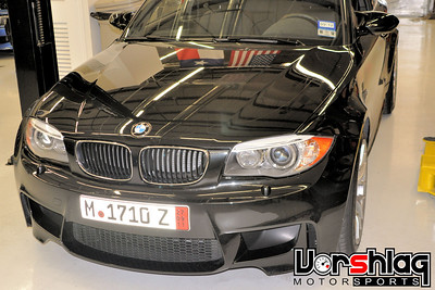

Just to compare the RS' 1:23.5 lap time to other cars, here's a listing of lap times I have driven at MSR on this same 1.7 mile CCW configuration:
So the Focus is in good company, and is quicker than my TTD lap record setting BMW 330 (above left) I ran in March 2017. We've made the TTD car quicker and lighter since then, but that's still impressive that the Focus on "street tires" beat a race prepped BMW on a 245mm Hoosier R7 (although the RE71R makes almost the same grip numbers). The RS' lap time is also knocking on the door of a Corvette C6 Z06 that I drove in stock form and only 2 seconds back from the 2017 Grand Sport (above right).

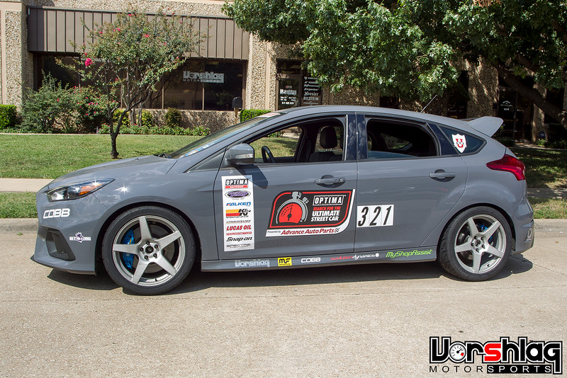

Todd ran the RS at a lot more Optima events after the suspension, wheel and tire upgrade and his placings shot way up within Optima's GTS class competition. The RS was always a crowd favorite wherever it went.
He also made more changes over the next few months before the OUSCI invitational after SEMA. The heat of this turbocharged engine was a constant battle and he purchased a new stock hood and made this ducted version below, which tested well at several high altitude and hotter events.
Todd did the metalwork himself and even got it painted and polished for Optima events, to try to score those Design and Engineering points.

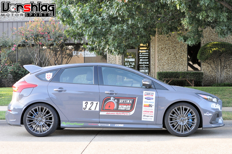

There were a number of other upgrades both mechanically and visually that Todd performed on the RS. The engine bay was dressed up (for more D&E points) and fitted with an Optima battery (it is their series). A bolt-in roll bar was added for some safety.

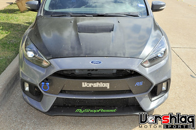

Vendors started sending him all sorts of parts, like these bolt-on braces that were added below. Magnaflow sent him one of the earliest exhaust systems to Todd as well. Being the first RS in the USA that was competing on such a visible series as Optima helped bring manufacturers to this car. Todd tested the parts in real racing use and helped get feedback to the various product engineers.
The Forgestar wheels were powder coated in the lime green color Todd likes, but they were kept off the streets most of the time (except for this alignment session at Texas Track Works) and the MPSS tires were used to ferry the car around the country to Optima events.
Eventually the RS accumulated enough series points and fans to get an invite to the annual 2016 Optima Invitational shootout, and Whiteline asked him to put his car in their booth. A carbon fiber hood was fitted to the somewhat famous RS at the show, too.

  • Optima at Charlotte Motor Speedway, July 30, 2017 - Video, bone stock RS. Todd finished 8th out of 25 in GTS class.
  • Optima at Circuit of the Americas (COTA), August 6, 2016 - Video. Todd finished 11th out of 26 in GTS class. Stock suspension, tires, upgraded G-LOC brake pads.

We have already made two production batches of the 3rd gen Focus/ST/RS camber plates, which we are selling to folks that have upgraded to coilover suspension. The Bilstein PSS coilover set we used on Todd's car is being offered for the ST (with our optional springs/perches/rates) and we will make the production parts to fit this to the RS.
