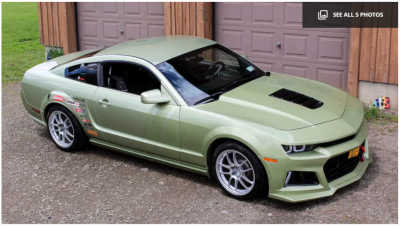

This swap including the car will have cost me less than $5k but that's mostly because I'm doing everything myself.
The Godzilla will come down in price as more get released onto the market and used ones appear in junkyards. That said, you obviously weren't going to sit and wait for that to happen, and you had the ingenuity to do an engine/tranny swap that most people would just shake their heads at and say "no way Jose". You also deserve a lot of credit for doing the work yourself and keeping the cost down.
Your transformation of what was originally a V6 has certainly got my attention and it would be nice if you could post a parts list with a breakdown of the cost. I'm especially interested in how you're marrying the Chevy ECU and engine harness with the Mustang body harness, and tackling other challenges such as the fuel system, cooling system modifications/upgrades, custom mounting bracket for Mustang V6 AC compressor, and what gauges you used.

It all nickel and dimes you to death, $20 here $50 there adds up quick.
The main expenses were the engine ($400), rear end ($300), shifter ($250), driveshaft (~$300, still haven't purchased that yet), holley 302-2 oil pan ($250), cheap headers ($100), and stuff like intake pipe, fuse box, wiring, etc all add up pretty quick as well.
The Mustang body harness stays mostly intact, I'm leaving the BCM and under hood fuse box to do all its non-engine control, using the stock Mustang starting circuit.
I'm using the stock fuel pump modified into a return style
I'm not keeping AC, the v6's AC didn't work anyways lol
The gauges wont work because they're controlled by the Mustangs ECU which isn't in the car anymore, I did see a swap where they kept it and added a bunch of Ford sensors to the Chevy engine in addition to all the sensors already on it to keep the gauge cluster functional.
I went a different route and 3d printed a tablet holder and making myself a fiberglass 3d printed tablet dashboard.. I included pictures of it in the gallery in the original post.. It's not done yet though but it's one of the big reasons I stuck with stock harness/ecu instead of Terminator X because I can interface a tablet easily with OBD2.
