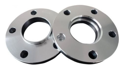

I have a 2010. so this caught my interest. Who makes the spacers shown in your pix above ? These look like the..real deal. Hubcentric..and only 5 holes. I would have thought that at least a 57mm et would be required on the rears. Have you got a pix of the front + rears with this 305/11" setup, like taken from the font and rear of the car? It would be much appreciated. Are you sure a 15mm spacer is all that is required for the front of a 2010. I did some rough calcs and thought a 25mm spacer would be required.

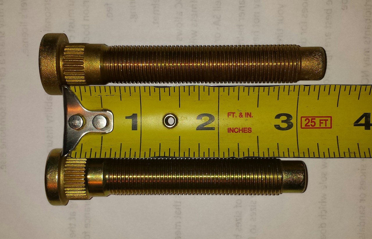

So are the ARP 3" studs, 3" using your above format for the oem (2.4") ?

I'm guessing it's the length from under the head to the tip, as that's the way most fasteners that are flat under the head are measured for length (as opposed to conical head contours that fit into countersunk holes). I never measured them, and I'd have to at least pull a wheel to do that now.
Whatever it is, there's a lot of turns required to snug up the open-end lug nuts. More than I've felt like counting, with plenty remaining for me to run the OE acorn nuts down against the open nuts for a measure of stud thread protection against corrosion. I've got one more track day coming up this year and I'll try to remember to take some measurements when I put the track wheels/tires on.

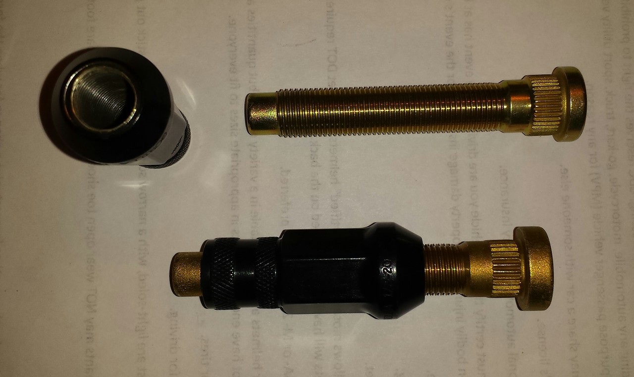

What brand of lug nuts are you using? I'm planning on switching to longer studs if I ever need to replace bearings.

They're the small-hex (17mm?) open-end nuts that should be shipped with any Forgestar F14 wheel. Got mine through Vorshlag.
Don't offhand know whose they are, though.

Studs are measured as Norm indicated, under the head to the tip. These are the ARP/FRPP studs for the S197 Mustang and measure at 3.315" front and 3.115" rear.
I've been using Gorilla open end race lug nuts measuring 3/4" across the hex. These fit nicely within the smaller lug openings found on many aftermarket wheels.
