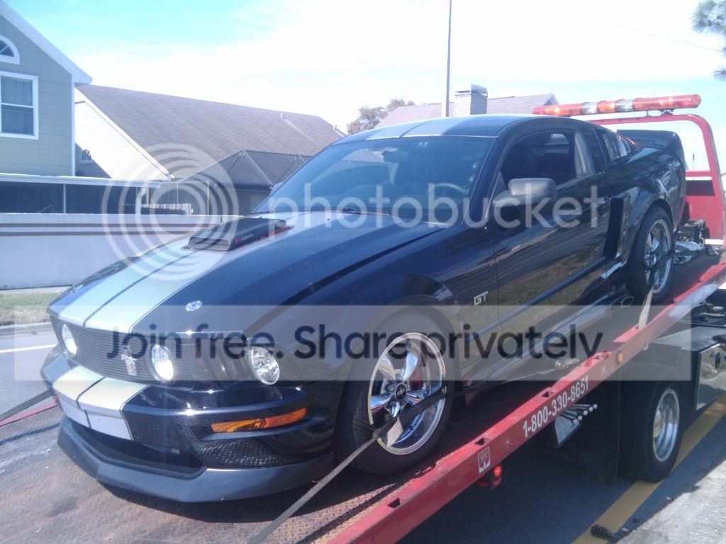

that picture makes me want to tear up a little...Yup that's true for sure!!!
After speaking with Brenspeed yesterday, they were saying that even the 3.2 pulley I was running was asking for trouble. They have two motor give at 3.4 but he said a 3.2 is just a matter of time and more often then not he has seen the motor give. But at the same time lots of people have run a 3.2 with success for a very long time. I'm just one with bad luck. I always have had shit for luck so I should have known.
