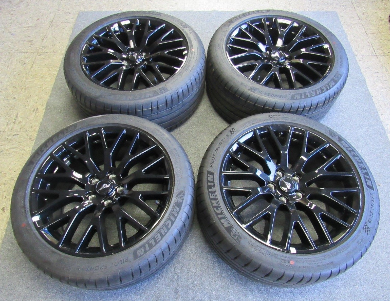

Thinking about the new body black 19s for my 07. Has anyone tried it? Wondering how they fit in the wheel wells
Struggling to get a pic posted from my phone so here's a link...
https://www.ebay.com/itm/NEW-TAKEOF...STANG-BLACK-19-WHEELS-AND-TIRES-/223230864553

That's not a bad price, The tires alone are $1200 ...
The offset's are close enough, the backspacing is the bigger problem, The S550's have taller brake rotor hats so the wheels have more backspacing.
They'll tuck under more on an S197 chassis, especially the rears.
S197 FRPP 19x9.5 wheel shows 7.05" backspacing with 44mm offset ..
S550 PP1 rears listed at 7.44" backspacing and 52mm offset.
Front S197 19x9 listed at 6.61" BS/ 40mm offset ,, the PP1 19x9 is 6.81 and 45mm.
You would probably want to run a spacer.

Dang. I do not like spacers so I suppose I will forget that thought and choose different wheels
Maybe I'll start researching late model s197 19s. I can get Ford wheels cheap so likely sticking with them

Should not need any spacers.
The 2007 GT500 was running 18x9.5 wheels with 7.13" backspacing. There's plenty of clearance with 255/45 and 265/40 tires that I know of for sure. You gain a little strut clearance going up to 19" from 18" because the strut slopes inward as it goes up.
Out back, you could run wheels at least 10.5" wide with a +52 offset wheel. 18x11's clear just fine even with offsets a little bit more than +52.
