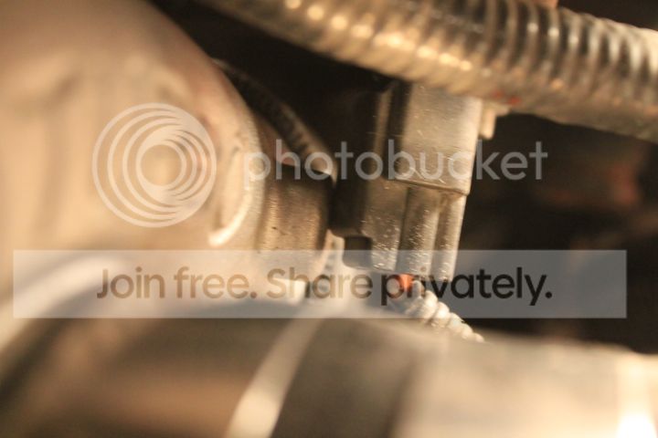

Is it normal for the turbo to be almost hitting this sensor?

You do not drill the housing for the BOV signal. BOV signal NEEDS to have vac
It sure looks like the bracket is in the right spot. My precision turbo doesn't have that bump on the compressor housing so my clearance isn't that tight. If you loosen all of the compressor housing bolts, you can probably clock it a little more to get some more clearance.

Checked the directions and looks like the bracket is on backwards. Need to drill and tap it for the BOV. The directions say to T into the line by the fuel rail and run to both BOV and wastegate.
BOV gets fed from vacuum like Josh said
Wastegate gets fed from the compressor side if you drill and tap it
