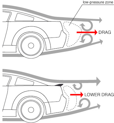

I'm also trying to do the balancing act with the size of the low pressure zone behind the car. In theory I want the low pressure zone to be as big as possible so the rear mount heat exchanger works better. But on the other hand I want it as small as possible to decrease drag.
I think I would rather have more cooling. You can never have enough of that.

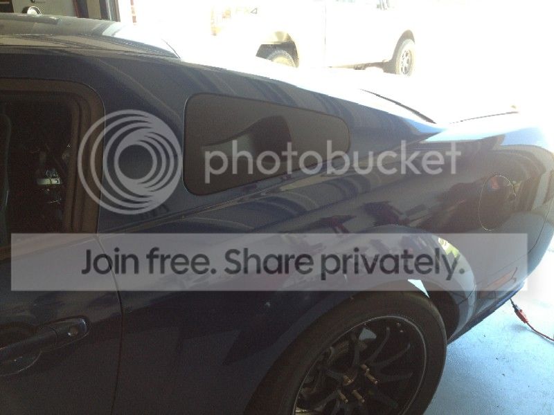

In theroy wouldnt the fans pulling hot air "out" of the trunk area and pushing it into the airstreem decrease the drag because insted of air and eddies spinning around the air from the fans push the dirty air out and into the slipstreem. Or do I have that backwards?

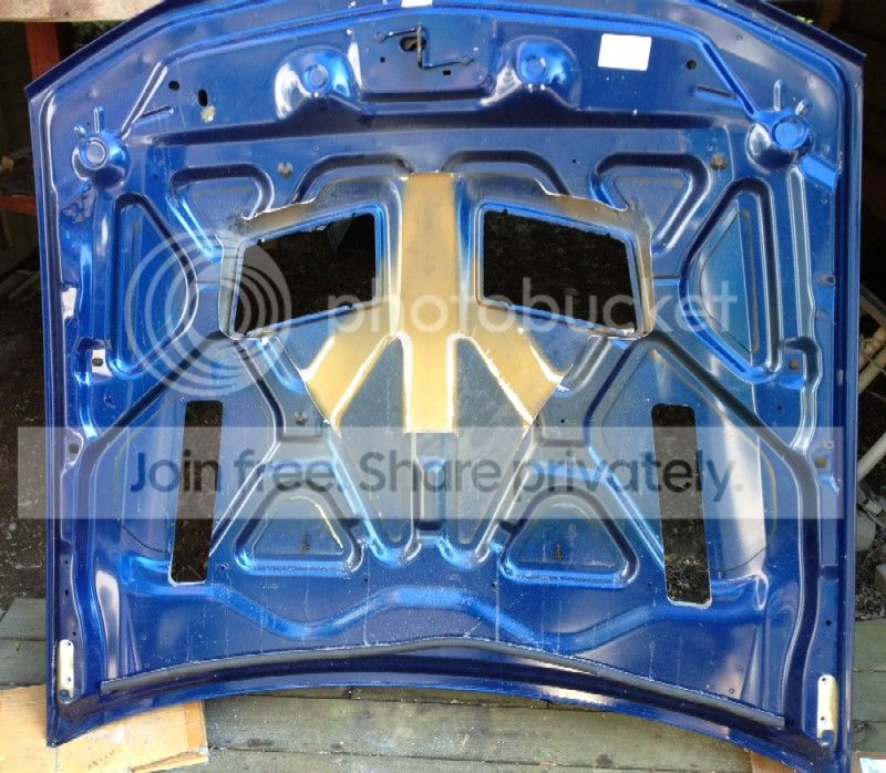

Gmitch - Not sure how big your blower is but the TR hood will clear the Shelby blower and pretty much anything the stock hood will cover. We've installed them on some cars that required trimming (Engine swaps, etc), and it's been pretty simple.
Since you're local, when you're ready, we can test fit one before you buy.

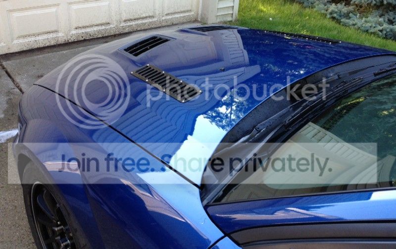

While you're at it, why don't you post up a pic of your hood vents. I never saw your "race" version.
There is a lot of “theory” going on with the back of the car now…..and no good way of testing it. Moving the boundary layer off the C-pillars with the NACA ducts, routing it through the trunk (effectively through the car) and exhausting it in the low pressure zone behind the trunk may be of some benefit. Or it could be a big mess, LOL! Those NACA ducts move a lot more air than I would have expected too. I really have no idea what is going on back there.

31
I have a 4.6L 3v with a custom intake manifold and a 3.4L Whipple with a Crusher inlet. One of a kind. It sits pretty high, but it may make it. I had to drop the motor 3/4" to fit it under the GT500 hood and the bracing from the underside of the hood is removed too.
I was hoping at some point that I could come down and test fit one, it is the only way to know for sure. And of course I would buy it from you guys.
Thanks for the offer.:thumb:

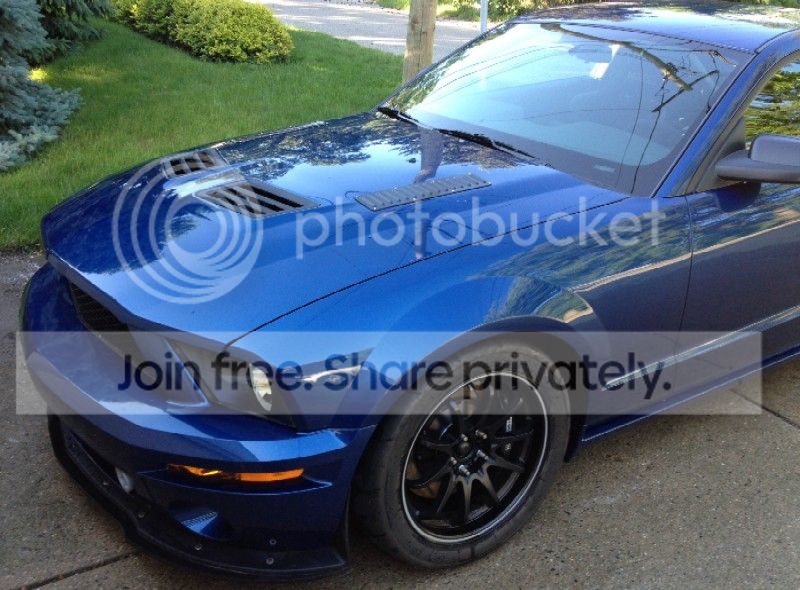

The black plastic inserts are all hacked up (I have spares). I wanted to do a quick test, and they are a PITA to hog out while remaining pretty. So I hacked away!
The add on louvers ended up being smaller than I wanted them to be. Which is an easy fix, just cut bigger holes and put bigger louvers in!
The engine compartment temps are a LOT lower now. A LOT! My standard for testing cooling is 75mph steady state cruising. At 75mph underhood temps hover around 10-12deg above ambient. They will still climb while sitting at lights, etc. But they don’t climb as fast and once moving they recover a lot faster.
No matter what I do it won’t be as effective as a Tiger Racing hood though.
