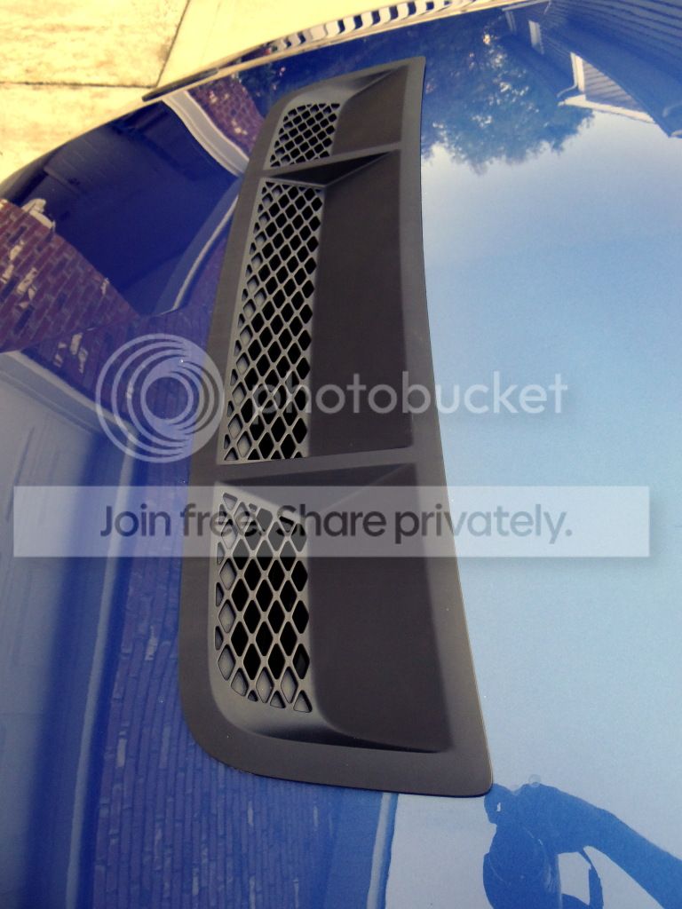

The louvers look great! I'll be getting a spare of my hood vent as well. The first thing I want to do is hack out all the honeycomb parts on the grill to see what kind of improvement I see. I imagine it will help quite a bit.

I guess you decided that adding the "scoops" underneath wouldn't really net any benefit?
[IM]http://i767.photobucket.com/albums/xx312/sqidd/Mustang%20Stuff/Hoodvent001.jpg[/IMG]
You will probably see a bigger benefit by adding a wickerbill to the leading edge of the vent.
Yeah, I'm sure you will see a HUGE improvement.:thumb:
More like I was so busy/lazy I said screw it and didn't make any, LOL!
I'm sure that would help.
Were looking into doing some drop in louver/scoops for the GT500 hoods. I just hooked up with a local guy who does race car louver stuff that can handle production on something like this. Fiberglass or carbon. A production design would have a wicker-bill added and more aggressive louvers at a minimum. Early days for this project though.

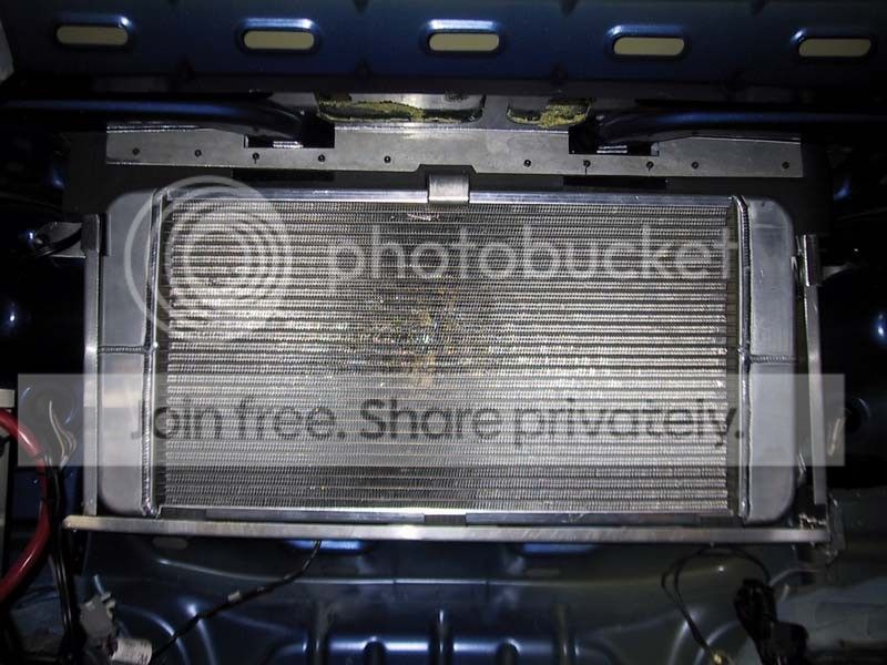

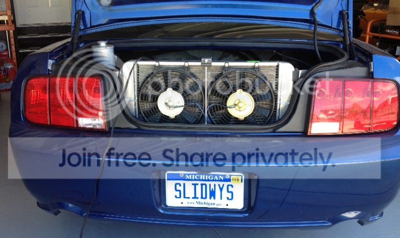

How exactly was the trunk vent made? materials? Im trying to visually see it in my head but cant quite wrap my mind around it
Cut out most of the trunk between the tailights, add some grill/expanded aluminum then a aluminum frame. It's obviously not easy, but the materials are minimal.
There is also an aluminum bulkhead between the trunk and the passenger compartment. The trunk is sealed up tight aside from where the NACA ducts feed in air.
It's not terribly complex on a theory level, but a LOT of work.

Here is what the trunk cooler looks like from inside the trunk. Note that it is sealed all the way around the cooler so all the air going through the NACA ducts is driven through the cooler.

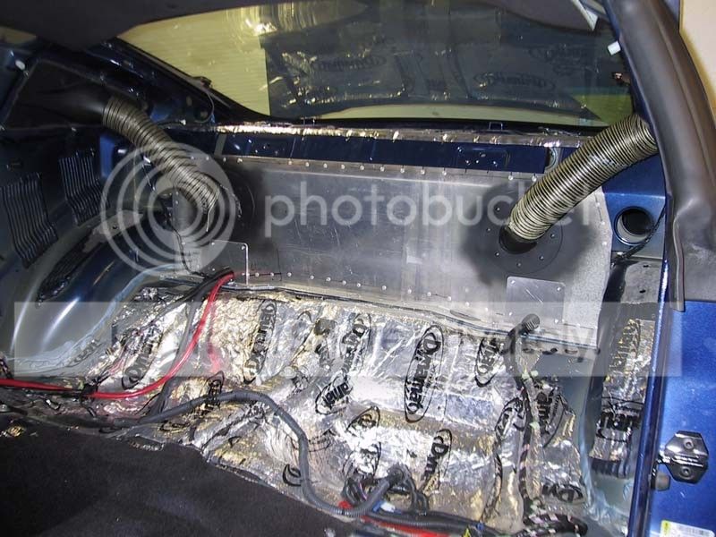

This is the bulkhead separating the trunk from the drivers compartment. It’s good for safety, gave us somewhere to run the NACA tubes through and it also stiffens up the chassis like the BOSS302 X brace. In this picture it is not completed.

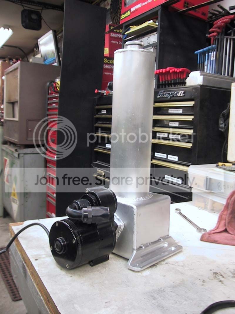

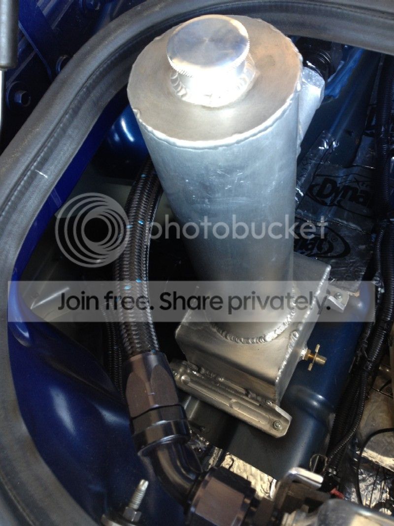

This is the rear overflow/degas tank with a 55gpm Meziere (one of two) built in. It’s tall and goofy looking because the rear cooler is the highest point in the system and the fill level needs to be slightly above that.

Total noob question, but why do you need fans/cooling in the trunk? I mean I get the bulkhead and the battery and all that, but the rest I'm at a total loss on.
