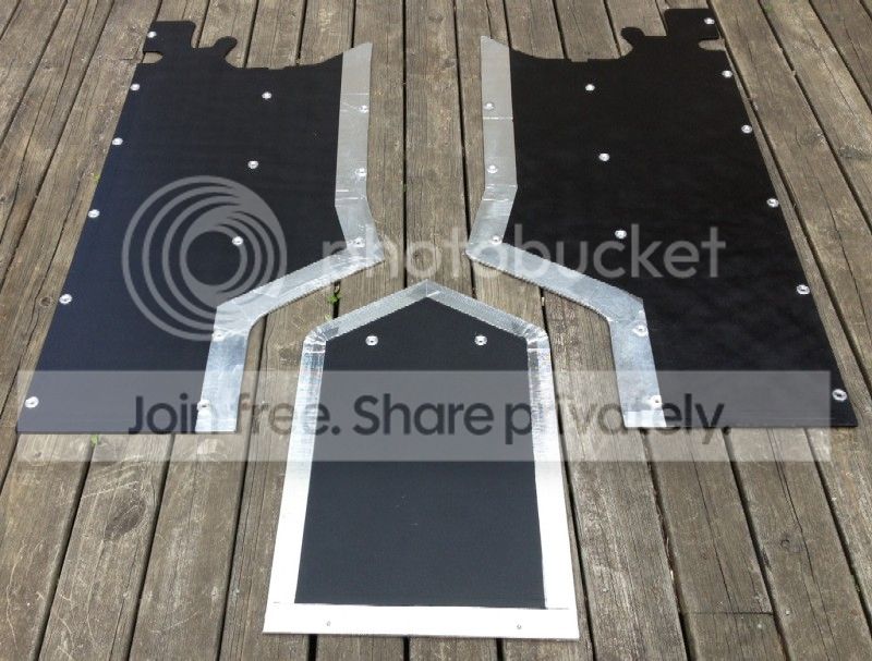

Thought you roadrace guys would dig this.
Huge thanks to 908SSP/Alex for doing this project with me. He worked his ass off on this. It wouldn’t have been possible without him.
Eventually the blue 2007 will be going for some big time top end in the standing mile (220+). And a lot of going fast is aero. We just finished the belly pan, which was a HUGE job. We have over 70 man hours and $600 in materials in the job.
We used 6mm aluminum honeycomb board for the panels then heat shielded the crap out of it with DEI stuff. The board is crazy light as well as very, very stiff. All the panels, brackets, fasteners, exhaust wrap, etc weighs under 20lb. Not too bad.
I may be crazy, but I swear I can tell that the bottom of the car is flat now. I did a high speed test run Saturday night and the car certainly didn’t feel like it was trying as hard to punch a hole. I’ve spent a lot of time racing in the 180-200mph range. I think I’m a pretty good judge of aero feel.
In the one pic you can see the splitter and the OEM 2010 “heat extractor” panel. Were going to test replacing the OEM 2010 “heat extractor” panel with a solid piece and see if it increases underhood temps. If it doesn’t we’ll use the solid panel, it should be more aerodynamic.
Next project, maybe next week, is to finish up the rear diffuser and add a trans cooler.

the lift mounting points/pads were already on the car?
def looks like it should cut down on drag

Looks great so far! Will the solid piece you are going to try in place of the stock 10' heat extractor be able to cover up any of the a-arm/suspension? Seems like the air is going to have a lot of chance to get stuck in that area. I also wonder if transmission temps will be affected at all and whether or not a fluid cooler might be needed?
Yeah, those have been there for a while (2yrs). They actually attach the K-member to the rocker/inner frame rail and stiffen everything up. Them working as jacking points was a bonus.
That is something we are going to look at/test. I would like to seal the whole underside up tight. But if that causes the underhood temps to go way up it won’t be an option. We’ll probably seal stuff up until temps ride then back it down a step. Being able to data log underhood temps is a very useful tool in this situation.
Yep, I mentioned it above. I have all the stuff for a trans cooler…….a BIG trans cooler (about 2.5x the size of the BOSS302R) ready to rock. It will get incorporated into the rear diffuser/bumper cover mods. Until then I’ll run around without the center section of the belly pan on the car.

Fucking awesome. Now that my splitter is finished I've been researching doing this myself on the time attack forums. Its nice to finally get a better idea of what it looks like on our cars. I'm excited to see what you come up with for a diffuser.
Did you finish the panel that goes on the axle like you were talking about doing or are you gonna run it open? I had wondered if having it sealed off and then suddenly hitting up bump disrupting the airflow would lead to a sudden (and potentially dangerous) loss of downforce.
Did you reinforce the honeycomb with fiberglass or anything? I assume you used riv-nuts for this job too.
Were going to finish the diffuser first and then see what we are left with. The plan is to seal that up though. We have plenty of panel left.
The honeycomb is CRAZY stiff! I’d wager you could stand in the middle of an unsupported (edges supported of course) 4x8 sheet and it wouldn’t budge. I won't be testing that on a $175 sheet though.:omfg:
Yep, LOTS of riv-nuts in that bad boy. There are 30 fasteners and 26 of them are riv-nuts. It only takes about 5min to get them off though and they are set up so one person can get them on without help.
