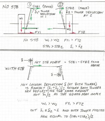

Seems my layout, sketch, and lettering skills aren't what they once were. Sorry.
If you care to try some rough numbers, let FY1 = 1700 lbs, FY2 = 300 lbs, STB1 = 570 lbs, STB2 = 100 lbs, displacement at tower 1 (unbraced) = 0.057" and displacement at tower 2 (unbraced) = 0.010" for a tower stiffness of 10,000 lb/in.
Those are just numbers for illustration but are at least in the ballpark for about 1g cornering.
Norm
