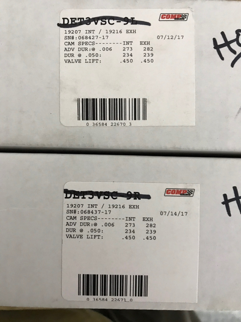

Comp Cams 127350 they require springs... but excellent drive-ability, good idle, nice power curve. Actually still using running them even with the turbo, and yes I know they are the "wrong" cams for a turbo.
MrAwesome987
Mar 6, 2019
936
292
Upstate SC
I have the Brenspeed Detroit Rockers SC cams in my car. The car is currently NA, but it drives pretty much like stock but feels a good bit stronger over 3800 rpm. It has a tad bit of lugging in parking lots if you are just letting it idle around, but its never been a problem for me. They sound great too.
Edit: And they don't require springs or lock outs.
