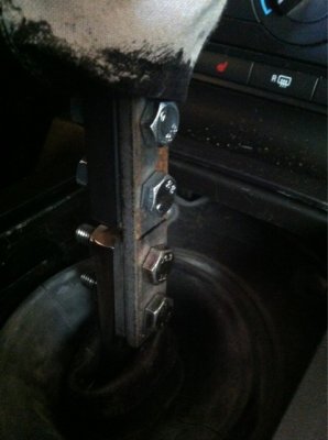

Here is my take in this issue.
I have always had this problem on all mustangs I have owned. I have owned 7 mustangs total. I had a neon srt-4 I never missed 2nd or 3rd, and my miata the only time I miss a shift is if I am not driving the car.
For me it seems like a shift timing issue, it depends where the clutch engages and how much pedal travel the clutch has. I have found if I make the shift lever longer it improves my shifting. I have a tri-ax in my 08 gt. with it in the highest setting with the stock knob I can shift fine driving normal but can't shift very well trying to shift at high rpm's fast.
Here is what I tried. I made a bracket to raise the shift lever higher and on top of the base. Yes this looks kind of funny but it has improved my high rpm fast shifting 100%.ImageUploadedByTapatalk1336183979.962729.jpgImageUploadedByTapatalk1336184027.900569.jpg
