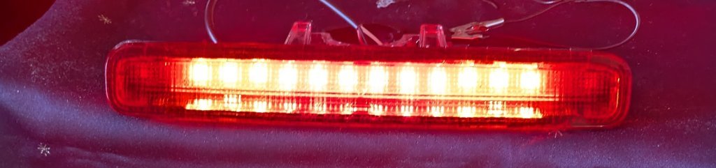

Well that too much of a LED look again..... white LEDs behind a red housing just always look odd for me. I see it in traffic too.
I alctually got a red 921 LED Bulb to go into the OEM socket.
I'm currently still trying to get someone to make the correct bulbs for me in the rear so I can run the sequential turn signals.
Have to have the middle and outer one turn off for the brake lights but the current LED bulbs have a delay from yellow to red which is not good for brake lights so currently only the inner most flashes.

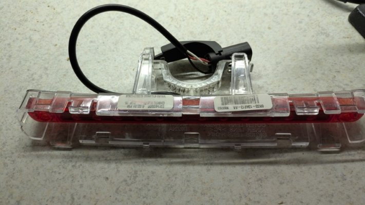

The brake light has a noticeable delay from pedal to light anyway. The LEDs have a ramp-up time, I think the SJB is wasting half a tenth of a second reaction time for the following driver. I don't have an oscilloscope but I'm sure the signal is not rectangular.
I just had the opportunity to drive behind a 2008 in the dark (very rare in Germany) and thought the 3rd brake light has the brightness of a single firefly trapped in a jar. That's why I changed it. The LEDs are red, btw.
Well the delay I'm talking about is about over 1 second...... that's bad. It's so the turn signal is yellow -> off -> yellow but I can't have that if they need to switch to brake lights.
So I'll need yellow -> red -> yellow which just don't exist for some reason, hence the other post I put up asking about custom LED Bulbs......
I also don't want any delay to the third brake light. It should all turn on at the same time and not 3rd -> 0,15sek nothing -> other brakes. Because that's noticable and probably someone either at TÜV or the police will complain.
I currently have a tiny DC-DC-Converter that just supplies all red contacts with 6.5V (I think) so they're active but don't visibly light up so if another source puts 12V they actually visibly light up. That'll get thrown out once I got the correct LEDs.
Really? Mine look way more redish (like even more than with the original 3157 bulbs) but maybe that's just the photo....
And I only use LEDs where I need to. 3rd will get a LED because I've seen them melt the socket but reverse light is also still a 921/W16W.
The Interior ones will get swapped to warm white LEDs just so I can actually see the interior and trunk at night.
Up front it's still all bulbs. If I can get someone to make LEDs that look like clear EU Parking lights through the amber housing that'll be the only ones up front. I want that amber housing and my side markers back!
And maybe HIDs but that'll take a bit aswell..... and I'll have to find HID look bulbs for the Fogs then and get fitting LEDs AGAIN for the parking lights.....
Yes I'm very picky if you hadn't noticed yet....

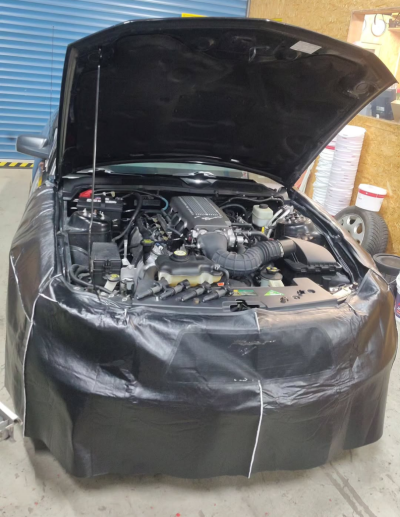

So..... been driving the Mustang for the last three weeks and..... It's just great.... I just love seeing pedestrians obviously staring while I drive by hahaha
But.... the stupid Modul to seperate the brake and turn signals is acting up and now only works when the engine is not running.... replacement does the same so I'll have to find another way to do that.... I do wonder if theres somewhere buried in the SJB firmware a option to seperate them, because if I unplug it one curcuit has a error code for turns and the other for brake signals.....
Also still looking to get the other LEDs made for the sequentials......

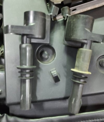

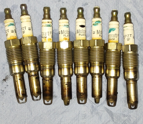

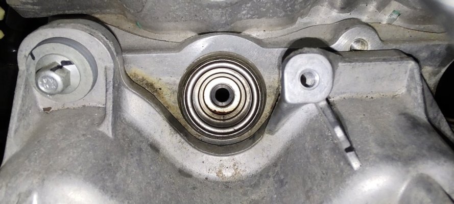

Other than that I also did the spark plugs and coil boots. I had already bought the extractor set beforehand but.....
8/8 came out! There's probably way worse since mine only had 30k miles on them, but I still had to soak them with fuel system cleaner and work them back and forth.
Driver side was particuarly sketchy feeling since they didn't gradually loosen like the passenger ones but just suddenly became very loose after being very tight....
Also got to try out the fender cover I bought and 10/10.

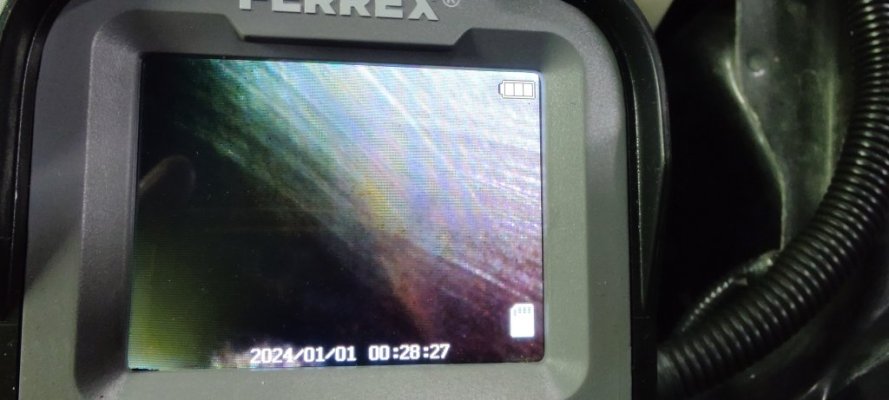

Crosshatching and all Cylinders + Pistons looked great. Cleaned the gunk out of the sealing surfaces and holes.
Blasted all the crap and fuel system cleaner out of the combustion chambers with shop air.

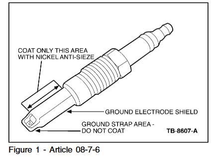

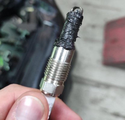

Gooped the Plugs with Motorcraft™ High Temperature Nickel Anti-Seize Lubricant (as per TSB), cleaned and new boots on the coils. Unfortunatly one coil plug broke so it's currently zip tied on until I get the new connector.
Flood Mode started it to remove any left over fuel system cleaner and fired right up.
The new plugs and better fuel will definetly help with the carbon build up.
Other than that drove it over 900km on a weekend visiting a friend and a S650 plus a lambo on the autobahn made me burn a quarter tank just doing pulls and I didn't kill myself haha.
Once the lift is empty we'll do the trans oil, power steering fluid, brake fluid to DOT4 and coolant. Rear Gear Oil I will do after the underbody is cleaned and sealed so they don't mess up the Ford Racing Diff Cover I'll put on at the same time.
Also in the process of getting some interior aswell as non fitted options parts over. I wanna put in the factory Anti-Theft-System aswell as Ambient Lighting still.
I think that's all for now lol

...where did you find /bought the fender-cover ? Looks great !
About the plugs... isn´t there too much of the antisize stuff ?
About the carbon built up... when the gas prices will fall ( I hope they will ) you can use SHELL V Power 100 or ARAL Ultimate 102 .. this stuff is amazing... used both in my Alfa Romeos TC engines. Cleaner than clean inside the cylinders..

badassfendercovers.com They're actually handmade in Florida. It is pricey but imo worth it. Plus you can't find shit for fender covers.....
I mean the TSB tells you to coat it that way. It doesn't look like it but the coat on it is actually really thin. The brush on that can lid also doesn't aid you in getting precision work done... But if I put any more pressure on it the metal would shine through. Yes I got some on the mating surface but it runs smoother than before and there was some carbon on that aswell so "viel hilft viel". Worst case I take them out again. Now it should be easy.
My buddy with his 13' Mustang actually talked to me about sharing a V-Power smart deal, since the more you use the cheaper it gets and I'll definetly do that. But for now I'm sure the 95 will suffice compared to whatever junk they put in before lol. I pumped out whatever was left in there before replacing the fuel filter.
But the best cleaning would still be blowing your headgasket.
