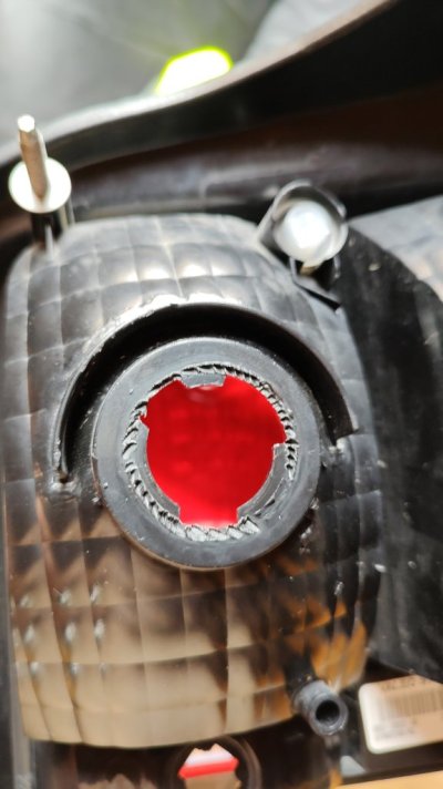

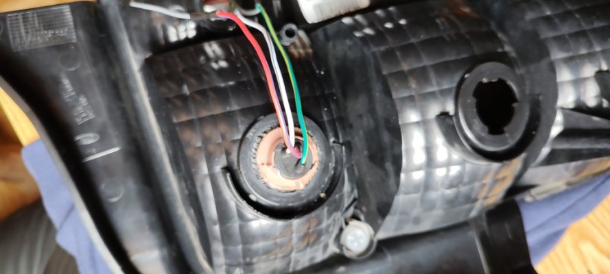

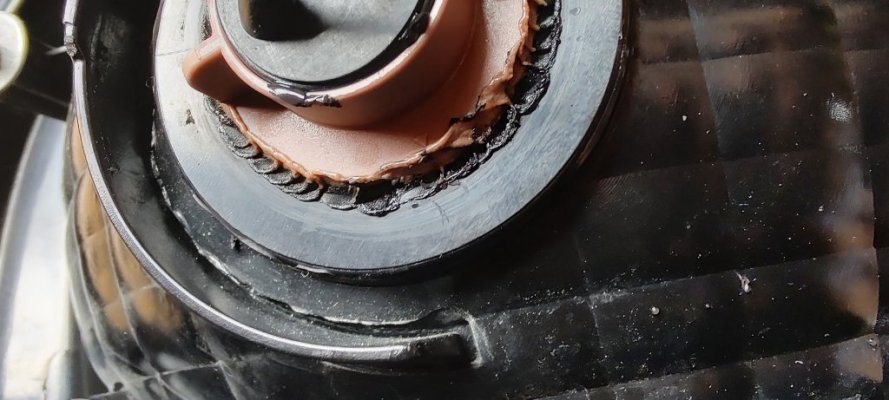

Things got worse. They didn't just cut up only the harness (which I got extra spares for) like they told me..... No because one bulb socket doesn't have two connections the put in a new socket..... and how did they do that? Find some splice in ones that fit the housings which you can literally find on eBay? Try and build their own sockets to fit?
NO JUST FUCKING MELT SOME RANDOM NOT FITTING SOCKET TOGETHER WITH THE HOUSING AND THEN COVER IT IN BLACK SILICONE SO YOU ONLY SEE IT WHEN YOU TRY TO GET THE HARNESS OUT TO SEND BACK THE LEDS FOR A REFUND AND REDO THE HARNESS:
IMG_20250627_132729162.jpgIMG_20250627_125714453.jpgIMG_20250627_125711569_HDR.jpgIMG-20250627-WA0006.jpeg
Great.... Tail lights are trash now because it destroys the seal when trying to get THE RIGHT SOCKET in..... the ONE thing I don't do myself....
I could see from the outside they used a different socket but thought the silicone was just to hold it in place, NOT THAT IT WAS MELTED TOGETHER.
Which annoys me most because the production date on them fit the car and I specifically told them I want everything to be reverseable and if they had told me WHEN I ASKED THEM we'll modify the housing aswell not just the harness I would have bought a spare of those aswell.... Can't even do what they're telling me.....
