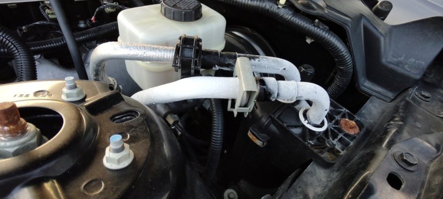

Also what the hell do you guys put into the A/C-Systems over there??? I never had a A/C-Line be forzen like that before..... Even next to the exhaust manifold it was frozen....IMG_20250815_194323722.jpg

Also what the hell do you guys put into the A/C-Systems over there??? I never had a A/C-Line be forzen like that before..... Even next to the exhaust manifold it was frozen....View attachment 109657
The signal lights look terrific !
About the A/C .. perhaps propane /buthane inside. Cools like hell...
They better do with all the shit I'm going through to get it like that.... (they already do)
I was kind of just joking about that but do they really put that stuff in there? And how would I figure out if I have it in? I don't want some shop at some point to fuck something up if I ever need a refill....

..the "recharge " from EASY FILL from Poland for example ..ist Propane Buthane.
The easiest way to be save, is to refill the system with R134a .

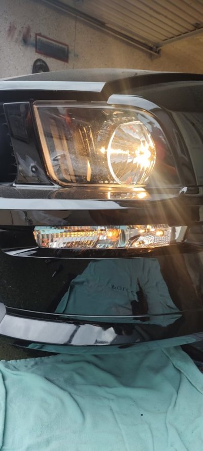

Brightness matched the LEDs (right) to the normal incandescent bulbs (left). They look like a different color on photo but are actually the same irl. LEDs do reflect better off the reflectors in the housing so it look fuller illuminated.
Currently waiting on my clear front turn signals (for two months now) aswell as my color spec'd wires to built the harness

Just refilled with R290/R600a, no problem so far, what should you expect? The fluorinated compounds was always money making from Dow and others. How to get rid of the dammed fluorid from the aluminum production? Oh, lets put it in the water, or in the fridge ;)

Take a look at the dryer below that lines. There can be a lot of water. I sprayed some corrosion protection inside that plastic box.

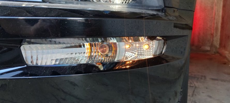

After two months the clear housings finally arrived. (Yes I know it's dusty, don't look at the penis drawn on the hood)
Since the front parking lights can't be amber I got these fully clear housings and swapped the clear 3157 with a amber 3156. (and snapped both connector unlock tabs for the sockets in the process..... why tf are motorcraft connectors 30$ each???)
Just had to shorten the side tabs so it would slide into the socket securly. What was the side marker will now be the front parking light.
Weirdly enough the SJB only monitors the turn signal circuit, so no DTCs from the GEM for the front lighting. Just a almost straight parts swap. I was completly expecting to need to add load resistors for that, even bought the sockets and connectors to put in between the original car harness and the socket in the housings.... well... luckily I didn't get expensive ones.

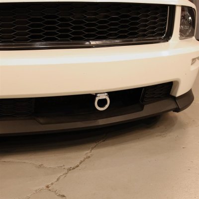

and 3. I need something up front where the car can be towed

And for 3. I got the SVE Tow Hook from LMR.com. Which I'll be able to hide nicely behind the front license plate bracket.
sve-mustang-front-tow-hook-05-14_64992737.jpgsve-mustang-front-tow-hook-05-14_ae5b1008.jpg
Plus it's another reason why I NEED to have the bracket - for pedestrian crash protection ;) so I unfortunatly I can't run the ugly standard german license plate in the front and NEED the better looking smaller one..... oh how unfortunate.... *insert the most extrem obvious sarcasm ever known to man*

..about the towing hook. My S197 has the hook attached at the frontaxle crossmember. A simple piece of steel . two holes..one for the nut /bold that holds the " hook/bracket and the big one for a rope..or whatever to tow the car..

But isn't that really low and behind the front bumper? Wouldn't that damage anything if the rope is angeled upwards? And I don't remember there being any holes in the crossmember that could work like that or maybe I'm thinking wrong.
