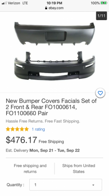

How's the fitment and how much other supporting items did you have to buy?
there is a part inside the rear cover that is riveted in that you will need to drill out the old rivets, then rivet to the new cover. For the front you will need the 2 lower grilles, and the lower panel (pictured) to join the lower shield to the bumper cover, other than that, its a bolt on...
