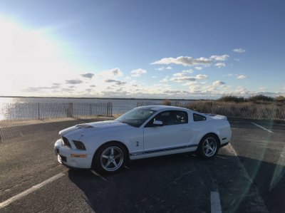

Your GT500 blends in very well with the contrast and shape formation of the clouds. Also really like the imagery details of the horizon, as you can visually see from the images that it goes on for infinity. Needless to say, you did an awesome job with the photos and also picked the ideal scenery location as well. Meanwhile, thanks for sharing :waytogo:

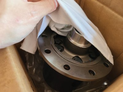

I had so many interruptions I couldn't tell you. Plus it was my first time and I stressed over the gear tooth pattern pretty badly. Plus I had to stop a few times to go get some or rent some tools I didn't have.
If I had to do it again, I could get it all done in a long day, pretty sure. See, I swapped my diff for a eaton trutrac and replaced every single bearing including my axle seals and bearings with koyos. I had a pretty bad amount of metal shavings in the tubes and pumpkin too. So I cleaned it very thoroughly. Laying on the ground and it being 29 degrees didn't help my pace either. So to lose my frustration and to not throw tools I repeatedly told myself I was in no rush.
Oh, and since I had the drive shaft down and mid mufflers out, I put in my mgw shifter that has been sitting around for a year plus.. lol
Just jerk the whole diff out and work on it on the bench.
By the way Anti; That is one nasty looking bearing.
Yea, it was ugly for sure.. lol. Someone had been in there previously too. It had three brands of bearings in just the diff housing..
I wish I could have pulled the whole axle out, but I had too much in my garage at that time.. :(
