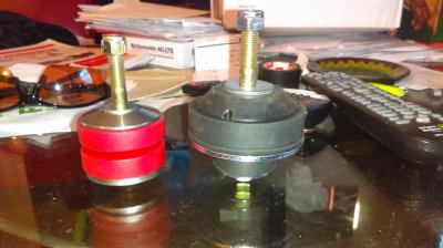

I love my BMR k-member but hate the vibrations I get with the poly mounts, I may have a solution. I purchased a universal, rubber, biscuit-style motor mounts, of course the bolt was not long enough to fit through the aluminum motor mount adaptors, so I fabbed up some longer bolts and an inner support bushing to act as the original shoulder and so far, so good, vibrations are much much less. I'm trying them out now to see how durable they are.

Looks like a good solution. Justin at VMP welded factory motor mount pads on a BMR K member on one of his cars.

I got some softer black from Kelly a couple years ago for my a arms,I haven't noticed the motor mounts being a problem
