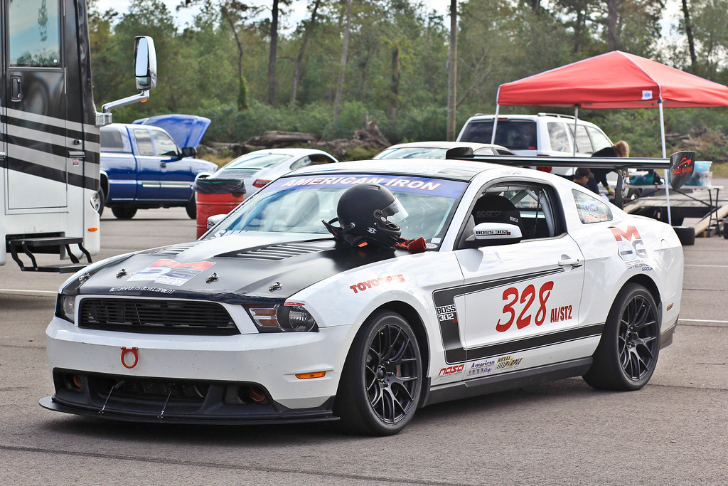

Terry, the weight of 3516 in the pic above, is that with a driver or equivalent weight in the seat? That seems pretty heavy if not...
I think because of his power in AI he is required to run Ballast to a certain weight without driver. Roughly 3500 may be that weight.

That includes my weight, with 364hp my min weight for AI is 3458lbs.
And yes, both coolers are in the trunk.

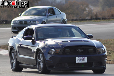

Project Update for Nov 30th, 2012: We had a track event in the Mustang since our last update and Amy set her new personal best lap at ECR. We've also finally modified the 2013 GT with real suspension bits, but that will be covered in that car's own thread. And after a considerable wait we finally have AST 4150s in stock for the S197 Mustang (and Vorshlag bought the entire order)!
Five Star Ford HPDE, ECR, Nov 17th
In our last project thread installment, we were preparing the 2011 GT for a Ford-centric track day at Eagles Canyon, our local 2.5 mile road course that is bumpy, but fun. This is where we do a majority of our testing and where Five Star Ford (a local Ford dealership - and where we bought our 2013 GT) had their first HPDE event back in June. This track is a brake intensive track, as I have mentioned before, and Amy drove the car exclusively all day and took the rear brake pads down to the backing plates. The pads were marginal when we got there and she still managed to get three HARD track sessions in before they started making racket and she brought it in.
Vorshlag Picture/Video gallery: http://vorshlag.smugmug.com/Racing-Events/Five-Star-ECR-111712/
Our photo guru Brandon went with us and took some great pictures, and Ed from Pirtek Plano South joined us out there as well. Matt brought his BRZ with our camber plates, some fresh 255/40/17 R-S3 tires and Carbotech brake pads and was tearing it up as well. I came out to watch, ride along and instruct, and to maybe take a few laps in one of our cars. In the picture above, I was riding through with Amy and it looks like I am yelling, but I'm probably saying "Gas! Gas! Gas!", to try to push her to faster lap times.
Ed and I (above right) got Amy's and Matt's cars ready, plus helped a few racers adjust camber or fix some small issues. I rode along with a number of other racers, including Matt in his BRZ, another FR-S driver Stephen F, and Amy in the '11 Mustang. After my ride along with me that day, plus Mike Patterson's in-car instruction from the NASA event in October, and maybe with some help from the new (more effective?) rear wing location, Amy lopped a second off her previous best lap to the tune of a 1:57.7.
Click above for in-car video from Amy's 1:57.7 lap.
This was again a pretty cold day (50s), very similar to the NASA event the month before, and she was pushing her braking zones and using more of the track on both corner entry and exit. She gave ride-alongs to Ed, me, and event organizer and Five Star Ford super dealer Corey White. Everyone had a blast riding along, the spectators loved watching/hearing her car on track, and she had the fastest car on track that day by a good bit. But as one onlooker said, "It ain't got that whistle!" :D
Vorshlag/AST tester Ken O and another Vorshlag/AST customer Jason had their E46 M3s out there in the Advanced group with Amy, both running Continental road race slicks (made by Hoosier). Ken normally runs 1:57s on Hoosier A6s, but could only get a best of 2:01 on these Conti's. I went out in a session in Matt's BRZ and had a BLAST, getting a 2:10.5 best after getting blocked on one of my few laps (AIM Solo showed a 2:09.5 predictive before that). Matt knocked off a 2:11.0, which was still damned quick especially since he hasn't been on track in about two years! That light, little RWD coupe is fun, with tons of grip and lots of brakes, but just very little power.
At the end of the day, the rear brakes were finally used up and it looked like we had a rear axle seal leaking a little (it melted), so we loaded up the Mustang and headed home. Amy had a grin from ear to ear and couldn't wait to get back out on track! I think we've created a monster - if I could convince her to let us build her a W2W car, I would love to get her out there mixing it up with the AI boys. The next day I unloaded the car at the shop and went to buy a (basket case) '97 M3, for parts, then unloaded that, so it turned into an all around busy weekend.
Repairs from ECR
