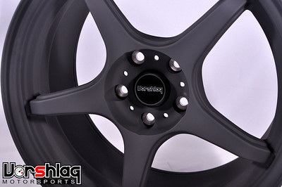

D-Force 18x10" S197 Wheel In Stock
Back by popular demand is the 5x114.3 bolt circle 18x10" D-Force Racing lightweight wheel. This ET43 offset wheel fits both the S197 Mustang and GR chassis Subaru STI without spacers. There are dozens of sets in stock in both Silver and Flat Black colors. These may not last too long, like last time, and will probably sell out before the next batch arrives. If you want a set, you can of course order them through Vorshlag. Thanks!
