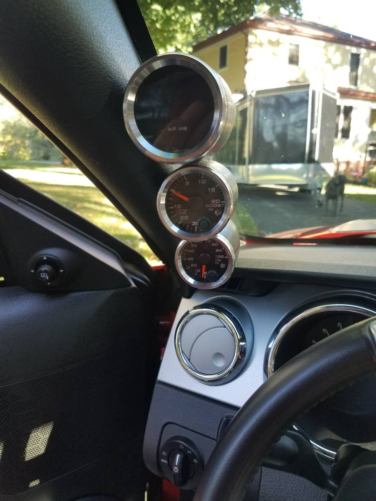

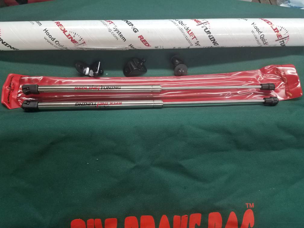

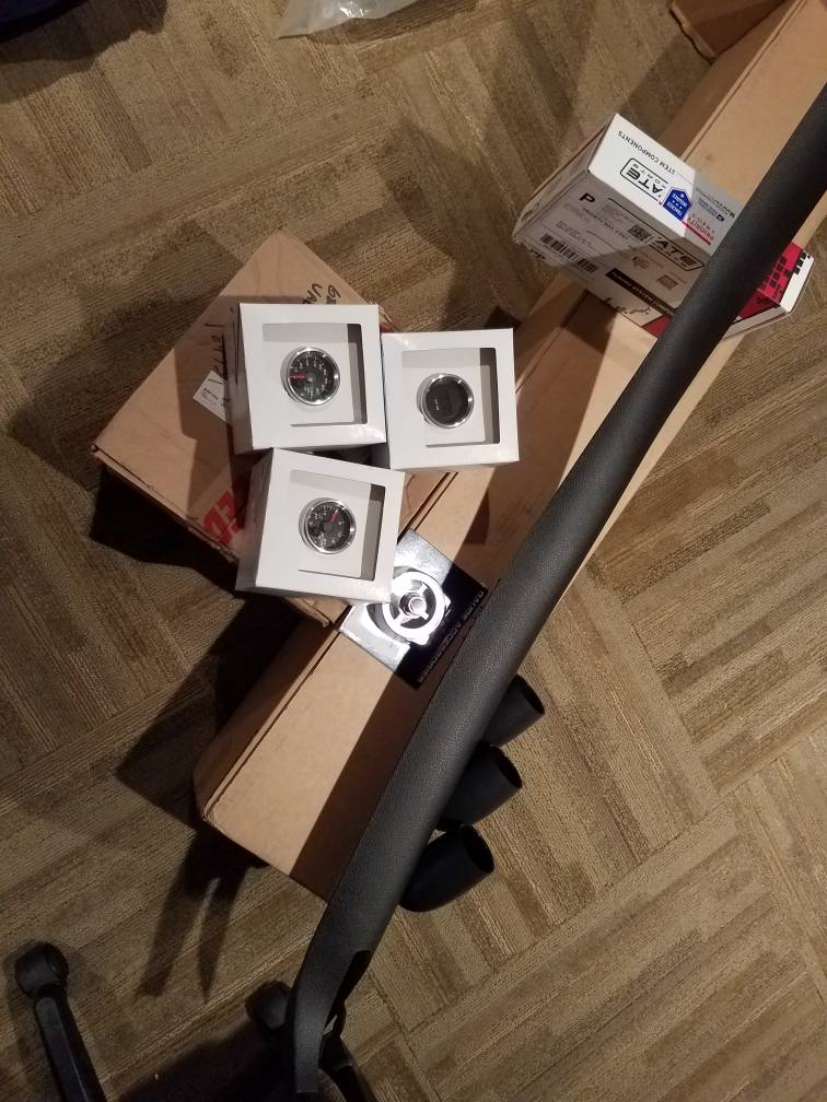

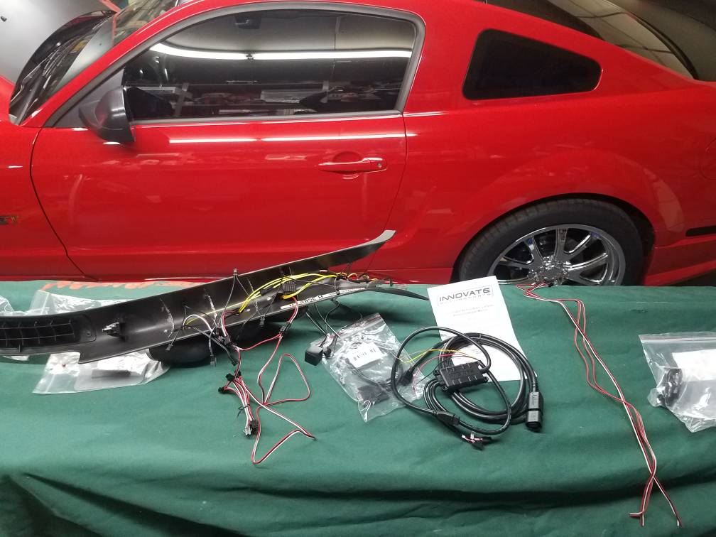

Hood struts installed! Speed Hut gauges, SOS triple pillar and innovate wideband controller for speed hut A/F started. I have to finish the wiring and get bung welded in. BMR pan hard bar with lowering springs, gt500 upper strut mounts and motor mounts ordered. Bilstein front and rears are setting here amongst other stuff collecting in the garage. Starting to think the wiring for the boost/vac may be to short.

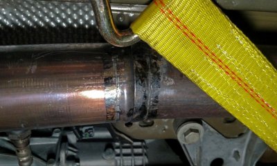

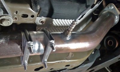

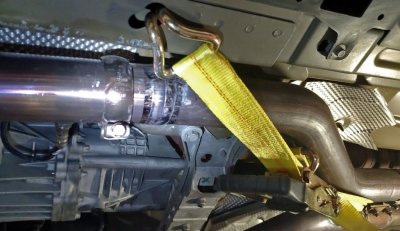

I got back under the car today to deal with my exhaust leaks, found only the driver side leaking at the joint between the off-road pipe and the front of the H-pipe.
Removed the clamp swore at the gap that I had to eliminate:
Thought of maybe using a ratcheting strap to pull the pipes together.
Figured it was worth a shot, so I did that, and that pulled it together pretty good.
Gave up on the factory clamp and got one of these from the local VatoZone:
Installed that, tightened it down to about 19 ugga-duggas on each bolt, making sure the joint is dead-center..
Still leaking a bit, but nowhere near as bad as before.
Drove it, and left some rubber here and there.

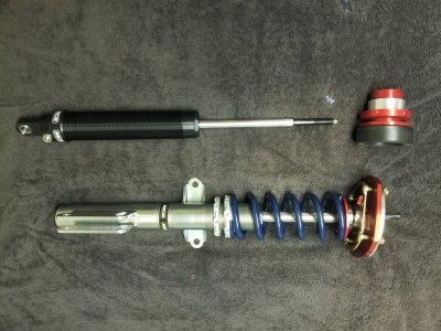

Finally, something photo worthy. These came in last week, just now had the opportunity to unbox my new Vorshlag TT1s. Unfortunately I won't have a window of opportunity to install them until late November.

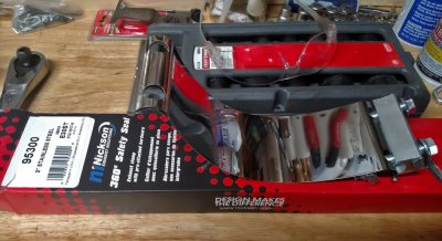

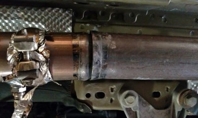

Finally fixed my exhaust leaks at the front of the H-pipe.
I resorted to cutting off the flared sections of the H pipe and the off-road pipes and installing a butt connector with regular old clamps.
Picture is before I cut off the ends off the clamps
Interesting. Looks like that approach would make installing an FRPP X-pipe a good bit easier as well.
Where did you source the butt connector?
Norm
The local Autozone.
Just made sure to get the 3" inside-diameter version, not the smaller 3" outside-diameter ones
Gabe
Whippled Coyote
Aug 7, 2011
8,610
1,827
Gotcha. Thanks.
Was concerned it might have been some specific Ford piece like the FRPP clamps that ship with the X-pipe and not as readily available.
Norm
Yeah, the local O'Reilly Auto Parts had the same choices.
The ones I got are regular aluminized stuff, not the stainless steel, but that was an option too.
This car doesn't see much wet weather, if any, so I thought SS was not really necessary.
