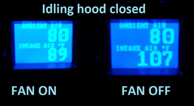

I started mine the other day, fired right up

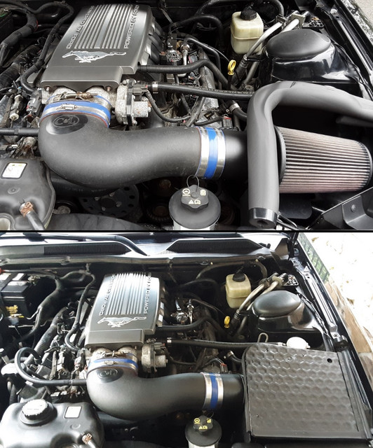

A fuse would be a good idea. How about some pics of it's placement. It sounds like a small jet engine starting. That's a nice drop in temp, Congrats

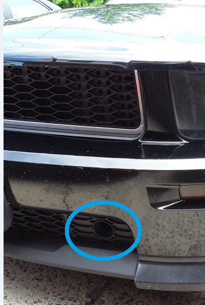

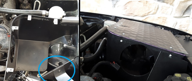

Made some brake duct inserts with kydex and a 3" intake adapter. Cut the brake shield to fit a 3" exhaust pipe section and welded together. The bare inserts on my C/S bumper was driving me nuts.......
