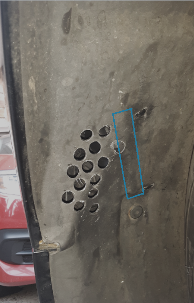

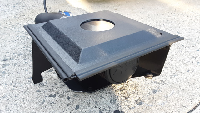

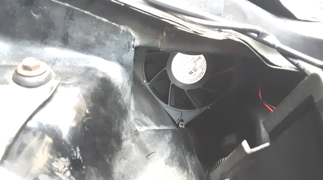

Sure, here is where it sits right behind the headlight in the fender well, tight fit in there but mounted it diagonally so it's flat with the fender liner and mounted it with some zip ties to it's corner holes. Really can't get any other size in there, the fan is 120mm Square x38mm thick.
And it's cool air source...
I was pleasantly surprised when I saw the IAT drop, great for waiting on line at the drag strip and not cooking your shit.

Your onto something here !! And where did the 120mm, 12 vdc fan come from? Never seen one with > 120 cfm. I believe the AC is..'off' when gas mashed ? Perhaps a 2.5" - 3" -4" diam tube would work.... but that's a huge hole in firewall.

The fan is made by Delta, it's a server fan most people wouldn't buy these for their PC's as they are loud as hell, draw some amps and are expensive.
https://www.frozencpu.com/products/...ead_PFB1212UHE-F00_No_RPM.html?tl=g36c781s562
Dimensions: 120 x 120 x 38 mm
Power Leads Length: 300 mm
Rated Voltage: 12 V DC
Operating Voltage: 8.0 to 13.2 V DC
Input Current: 4.00 A
Input Power: 48.00 W
Speed: 7160 RPM
Max. Airflow: 252.85 CFM
7.160 m^3/min
Max. Air Pressure: 1.412 IN H2O
35.877 mmH2O
Noise: 66.5 dBA
I am actually wondering if I can fit two 92mm fans side by side (175cfm each) in for a combine CFM of 350.
https://www.frozencpu.com/products/...an_-_17503_CFM_PFB0912DHE.html?tl=g36c781s700
RPM: 8000 RPM
CFM: 175.03 CFM
Noise Level: 66.5 dba
Watt: 37.20W
Amps: 3.72A
Connector: 3 wire bare lead

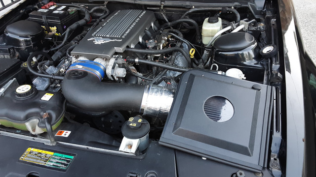

FYI for anyone thinking about it like I did, trying to insulate your MAF housing from heat doesn't work. Glad I at least tried it though, it's slower to get warm but once it does the heat from the MAF housing can't escape and it does not cool for a VERY VERY long time.
So that's a no go! As soon as I took off the insulation the degrees started coming down.
Can't do much about MAF heat soak being that there is literally a heat gun (radiator fan) smacking it with hot air. ah well!
