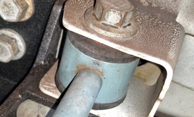

Put the wife's Shelby up on jack stands (no, not Harbor Freight ones, lol) and started checking out the bushings, mounts, everything at the back of the car.
We've been feeling/hearing some knocking/clanging at the back of the car, sometimes over bumps, sometimes when shifting.
Found some cracks/tears in the upper diff bushing and a bunch of cracks and worn bushings in the stabilizer links and stabilizer bar bushings.
Ordered parts. New Prothane bushing for the upper diff mount, new Energy Suspension bushings for the stabilizer bar and links.
Also spaced out the main BMR Watts Link brace away from the spare tire well a bit, as it seemed to be touching. And even though the main brace is firmly bolted to the body and doesn't move, it was too close for comfort and I thought that maybe between the worn bushings and the brace touching the body, maybe it would occasionally bang against it. Meh, I thought I'd eliminate a possible source for a noise.
Some pics and a video of the carnage:

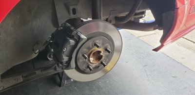

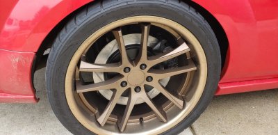

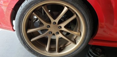

I put my 2014 gt500 rotors and bracket on today. Bout to go for a spin and break in the pads.
Before
Comparison
After
