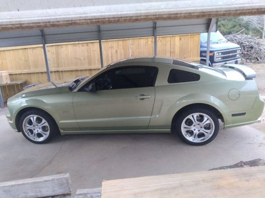

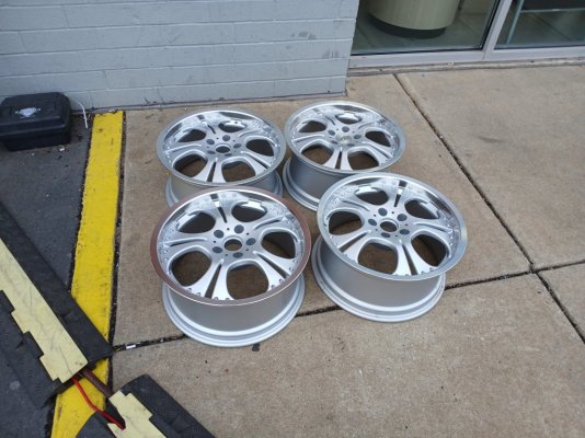

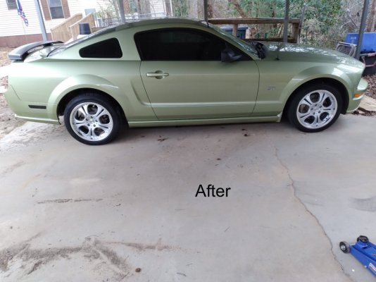

Bought new 18" wheels and tires today for the 2005 GT to replace the 20" that were on the car when purchased.
The new wheels are 18" x 8.5" with a 30 mm off-set. New chrome lug nuts came with the wheels.
Tires are 235/45/R18 front and back. I'll post a photo or two of the new wheels and tires on the car tomorrow.

That size tire is pretty short at 26.3" .... S197 fitment is usually around 27-27.5" tall

Cool wheels. Did you get hub-centric rings too?
I'm not sure what hub centric rings are, but they did come with caps that snap into the hub bore.

Most aftermarket wheels, especially wheels that are not specific to mustangs, are lug centric vs hub centric like OEM wheels.
Hub centric simply means the hub face fits inside the center bore of the wheel. Hub centric rings ensure the bore of the wheel is centered on the hub.
Most aftermarket wheels are lug centric which is usually less strong to lateral forces since you are using only the lugs, and can also lead to vibrations.
JC SSP
Nov 8, 2022
2,283
1,353
FL
Most aftermarket rims are lug-centric meaning they align via the lugs. OEM and quality aftermarket rims which usually are vehicle specific are hub-centric, where the rims fit snuggly over the hub.
Hub centric rings (aka spacer) take up the slack between the rim and hub, providing a tight fit which trans lates to no vibration or wobble.
You can still get a great ride with lug-centric, but these rings make easier.
The spec I found for OEM tires (235/55/R17) is 26.77"
Yes, the new tires are a bit shorter.
The 285/35/ZR20 Nittos that came with the car, are suppose to have a 27.87" OD.
Too tall.

JC SSP,
The 2005 Mustang wheel hub diameter is reported to be 70.5 mm.
The hub bore in these new wheels is 73.1 mm.
The hub ring would be approximately .06" thick.
Are there hub rings made that thin?
(There is more to specifying a wheel than I lead myself to believe)

The hub-centric rings come in many different sizes. Usually, the manufacture of the rims or whoever sold you the wheels has a chart/list with the specs and options (plastic, aluminum, nylon, etc.)
Please double check the size... Also, I am not affiliated with this company, just a quick Google search, there are many vendors out there.

JC SSP,
Thank you for the info. Bookmarked.
The dealer I bought from contacted Ace Wheels this morning. They told him hub rings were not necessary, just use the lug nuts provided.
I may not be seeing some feature on this wheel or the lug nuts.
Too tall.
285/35/20 is actually a great size for the back of an S197 Mustang.
Hell, I'm running 275/35/20 on my wife's '08 GT500. That tire is about 27.5" tall and looks great on there.
I've run 305/35/20 rears on my '13, that size is 28.4" tall and it was fine. No rubbing, no issues.
On OEM 18's the car comes with 235/50/18 which is about 27.25" tall.
2007-2009 GT500 came from the factory with 255/45/18 fronts and 285/40/18 rears both 27" tall.
Yes, I'm going on and on. I guess I just really don't care for short/thin tires.
But sometimes it takes having the first-hand experience to believe it.
