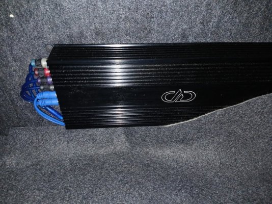

I am glad there is someone else who has a Kenwood in their s197. There are so many different settings with this Kenwood, have to get use to them, then figure out how to save the settings.
The door speakers (woofers?) are shot, or under rated. With the bass tweaked up a bit, they distort. Turn the bass off and they sound OK.
There is an amp in the trunk, and what brand it is, I have no idea.

Google image search on that logo says it's DD Audio (Digital Designs), not familiar with them either but seems like they've got a pretty good reputation for premium stuff.

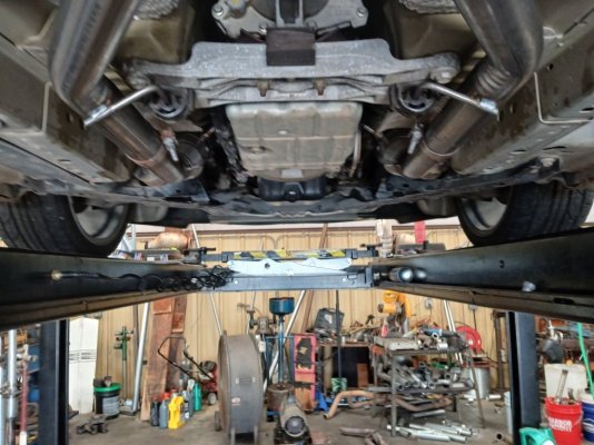

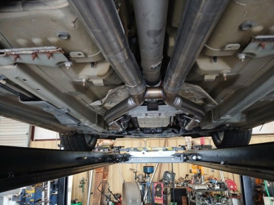

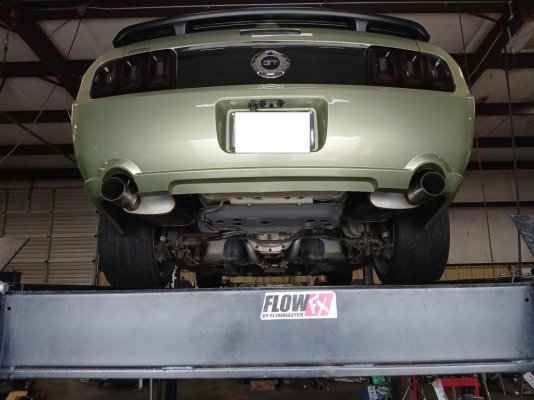

Today, the '05 GT is having all the new exhaust parts installed and welded.
The O2 sensor in the exhaust manifold is stuck. They don't want to break anything, so I may have to remove it myself.
The car should be done soon.
Later: Here are some photos of the exhaustive work. Re-used the tips that came with the car.
I like the sound.
Last try, break off the sensor and use a normal long socket, these slotted lambda types are crap. In my case propane/butane torch was not hot enough and the slotted type widened and slip

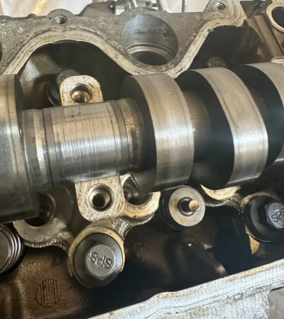

The head can be repaired. Camshaft is toast. No idea why it happens. Age? Poor service?
StockishS197
Dec 24, 2024
434
378
Houston
Probably caused by lack of adequate oil pressure at idle. On 3vs, the cam caps are usually the first to go. Those cam lobes look real dry and sus. Not a nice polished finish
Would be curious if they would be able to line hone and insert new bearings considering the cam cap and head don’t have inserted bearings.

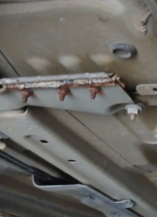

Griffx,
That bushing was used by the mechanic to space the exhaust pipe before welding. I didn't see it when I took the photo. The mechanic removed it.
I was not aware of any deflectors used on the off-road system. Does it require some?
Now that the exhaust noise is less, I'm hearing noises not noticed before.
JC SSP
Nov 8, 2022
2,283
1,352
FL
I removed those when I did my subframe connectors. The rubber was rotted and they got in the way of the ladder bar style I have. I don’t think they are that important but will default to others that know more about the part.
