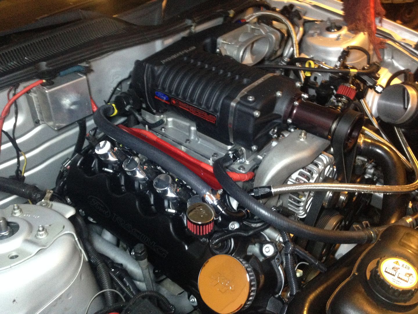

I've had my Whipple on my car for over 50K miles of abuse as a daily and a track car. She'll do 11.6 in the 1/4 with stock bottom end. Install was relatively easy and really not all that intrusive. I live in the high desert and never have had any temperature issues but I also run an electric H2O pump which makes a huge difference. the Whipple I do believe comes with a larger intercooler than KB. Never liked the Edelbrock unit. The TVS is a good unit too. I just prefer the twin screw over a centri but I'm an old fart.
