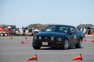

I don't think my Mustang ever rolls much more than what this thumbnail shows. I'm not quite to the point where I can feed in much throttle without compromising my line through the next couple of course features, so it's pretty close to a max steady-state cornering shot. Camber looks OK (it's set at about -1.8° static), and it seems to take a set quickly enough.
There's a difference between making 'quick inputs' and being late getting them started. Autocross slaloming can teach you that it takes a finite amount of time to get the wheel steered from straight ahead (or turned the other way) to wherever it needs to be to negotiate the upcoming turn. During that time, you travel a finite distance down course, so it only makes sense to get your turning started a little sooner so that you get the right amount of steering dialed in at the right time. IOW, don't react, anticipate. This goes to teaching your hands to be slow (and generally move the least amount necessary) and is probably good practice even in street driving.
