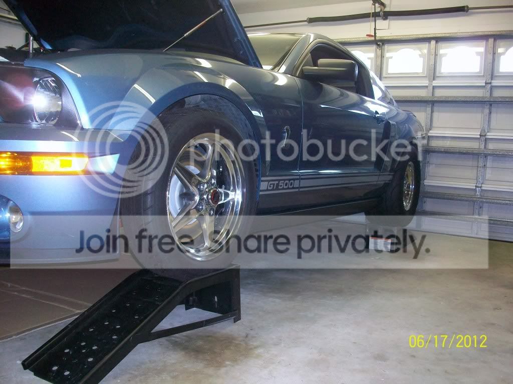

This morning I raised the vehicle, supported by the tires and level, and readjusted the pinion angle. The pinion flange angle is now 1.7* lower than the transmission output flange angle.
How did you elevate the car like that? Drive up on the ramps on the rear tires and jack up the front?

I never drive up on ramps. I raise the vehicle with a floor jack and then only use the ramps to support the stationary weight of the vehicle.
+1 That is how I did mine. I need to get better ramps. I had rhino ramps but I barely fit under the car. Is there different heights to ramps? If so where can I buy the tallest? I need to reinstall my watts link at some point and the car needs to be at ride height to get the geometery right. I know I am not going to be able to install that with the car on those rhino ramps!
