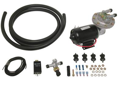

Vacumn pump?
$300 12 Volt Electric Vacuum Pump Kit. These Stainless Steel Brakes electric vacuum pump kits are designed for use with a supercharger or big camshaft. They include a 12 V electric vacuum pump to supply your brake booster with the required power for brakes or other sources.
Includes 12 volt vacuum pump, switching relay, vacuum line and control, mounting insulators and hardware. Dimensions: 8" L x 5" W x 7" H (approximate). INSTRUCTION GUIDE

Was looking into the vacuum pump, but there are others with these cams and larger and don't have an issue, also, my brakes work fine. I just want to keep from wasting anyone's time; lito, and waste money on dyno time that is a 2+hr drive from me.
