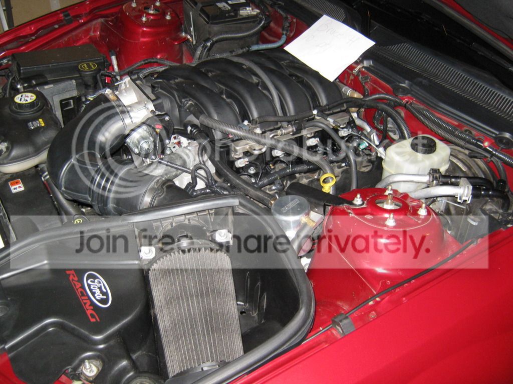

I'm posting a picture of how the engine bay looks at present. It looks like a stock motor with a cai and valve covers. Very stealthy. The engine wire harness has been changed out to a brand new one to help with the stock look. The original harness works just fine but it had been lengthened and shortened a few times over the course of my different setups. I wanted all the lengths to be where they should be and just didn't feel like rebuilding the original harness.

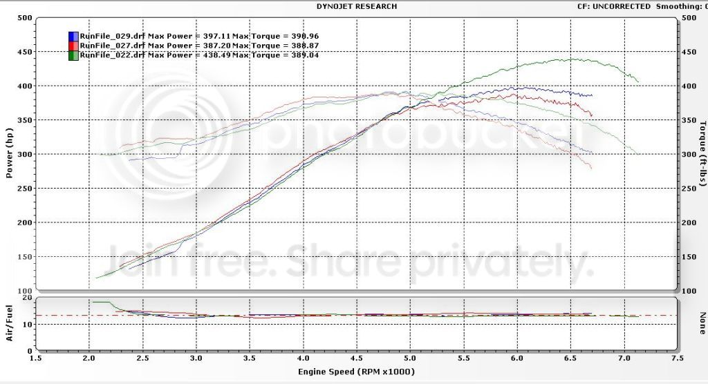

Updating this thread with some more info.
Some time ago I put a stock intake manifold with cmcv back on the motor, also went back to factory cats.
The only apples to apples comparison would be with E85. Changing from the FRPP intake, 62mm tb, C&L Racer, and Mac LT headers with high flow cats dropped 40rwhp. Those parts were replaced with a stock intake with cmcv, 55mm tb, Bullitt cai, JBA shorty headers, and stock cats. The power drop occurred above 5k rpm.
The numbers on this sheet represent the old setup with with E85 (438/389), current setup with E85 (397/390), and current setup with 92 octane (387/388).
All of the power drop happened above 5k rpm. This leads me to believe it has to do with airflow. Either in, out, or a combination of the two. It could be the 55mm tb or the Bullitt cai or the stock intake manifold. It could be the exhaust setup.
I'm not really disappointed in anything. Drivability is fantastic, the motor looks pretty much stock, it gets over 18mpg in mixed urban driving (mpg went up 2mpg just by adding the cmcv). I also know that at least 438rhwp is obtainable with a day of swapping parts back.
The motor is built to handle whatever I can throw at it. That could be forced induction or daily driving with pump gas. Maybe one day I'll start swapping parts out to chase numbers again.
