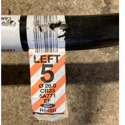

The Laguna Seca edition of the Boss got the biggest rear bar. I'm pretty sue that is the 26mm that you are talking about. I have one but never put it on my car, PM me if your interested in buying it. I have no idea how much it would cost to ship.

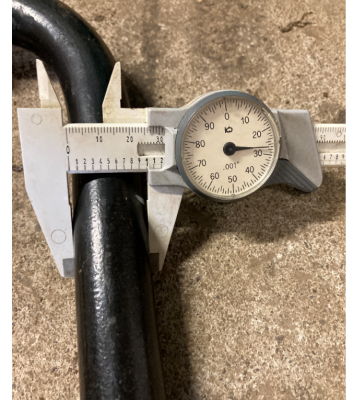

The big sway bars seem to be slightly under 20lbs. Lots of dealerships are selling the Boss 25mm bars for about $120 plus $20 shipping. Full price seems to be about $180 or so at the local dealership. The 26 mm you have is kind of rare and you need the vin to get one. Are you sure it's a 26mm? The inch sizes are .95 for the 24mm. Then .99 inch for the 25mm. The 26mm of course is over an inch.

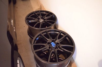

The Brembo wheels I am working on. One needed a little touch up. The other three look like new.
