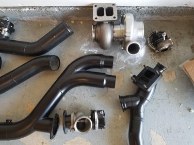

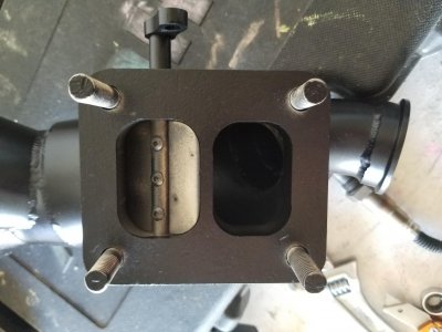

Here is the setup I have going on. Will feed one side of the turbine scroll till about 12psi. It's a 75mm turbine 1.15ar so about .58 per scroll. Like mentioned not expecting much little better transient response and low end torque. Peak boost may come in a few hundred rpm sooner, we shall see.

This will certainly aid in scavenging, you might be able to sprinkle some extra timing in it due to the reduction of cylinder temperatures. Did you have cams spec'd for this system???
