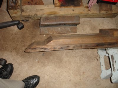

It's a bit easier to drive up on DIY ramps if you cut the ends at 45° to the ground or shallower. This is something you're more likely to become aware of if your car has a manual transmission.

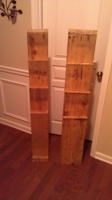

Had a "2x"10x'8 pressure treated lumber laying around so I decided to try this out (at work). I did mine as the link on page one ("17,"30, and "43). This got me to a height of "4-3/4. I can access the oil pan to do an oil change and inspect the undercarrige easy enough but, I don't think that there's enough room to work with if I needed to manipulate/remove the mid pipe, for example.
Four boards seems to be the magic number. This thing is heavy as is. The next board needs to be "56. That's crazy heavy, IMO.

My rear ramps are 2 by 10's, 4 layers high. They are heavy mofos. Fronts are 2 x 8s, also 4 layers. A good bit lighter.

I've decided to add the 4th board and keep them close to where I'll use them. I can't see myself dragging them around more than a few feet. Yeah, I bit ghey, I know but any more weight seems like more trouble than its worth. Not to mention that at "56, that's almost a 5 ft ramp!
I'll add the extra ramp this weekend and report the weight, if anyone cares to know...

My ramps are 54" high. 8 inch ramps weigh 30lbs, 10 inch ramps are 43.5lbs. I'm sure the 10 inch is pressure treated, not sure about the 8s.
Of course, with most wood the 8 inch is only 7" wide and the 10 inch is only 9" wide.
Also, the 8 inch ramps have a stop screwed on, the 10 inch ramps are for the rear and wouldn't fit under the car with the stop. Actually, the 4 layers doesn't fit under the car either (even before the roush rear springs) so I have to drive onto some scrap pieces (rear tires only) before sliding the rear ramps under the car.
