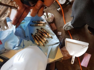

theRedStorm
Aug 30, 2015
150
21
Awesome!
What method did you use to ensure extraction in one piece?
3/8 ratchet and a pipe extension LOL
I soaked the plugs in seafoam deep creep for over 2 hours prior. And for 3 of them that didnt wanna budge, I turn em a quarter turn and more seafoam deep creep for 20-30 mins. I ran a fuel system cleaner in the gas tank for about 20-30 miles too.
