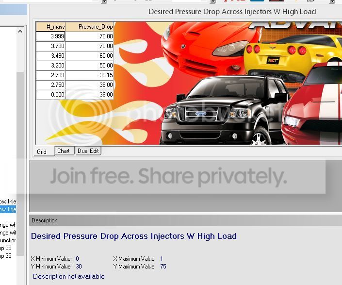

What delta did you calculate at? The stock tune will command up to 70 psi with higher airflow. This makes the injectors able to support a whole lot more power than the standard 3 bar psi used by most calculators.
The 5.0 takeoff injectors work well and are well priced. The old 39lb blue cobra injectors work well for a budget price too.

Delta is the fuel pressure you used for your injector calculation. Most online calculators don't take into account a variable delta that is possible with a returnless fuel system.
The 5.0 injectors are 32lb at 39.15 or 43.5psi, I can't remember which but they flow about 33% more than the stock 24lb injectors that come with a 3v.
A slight hesitation can be caused by many things, I really doubt it's your fuel pump. I say this because the only hicupp I've experienced was tune related.
