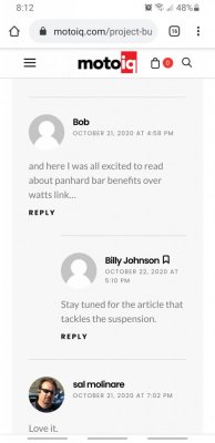

He mentions an article discussing the PHB vs Watts link . . . did that ever happen?
