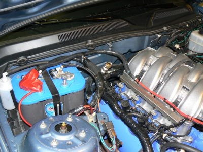

Great runs at the track you should be in the ten's soon. What is your CR on the engine? That hose is the overflow for the trans. I pulled mine out and made my own overflow out of a hydraulic fluid plastic bottle and 3ft. of trans hose.
I'm also running E85 just bolt on's for now stock engine auto and 125shot.
N/A 299HP/318TQ ,on the bottle 390HP/440TQ .

yep already made a breather tank and mounted it. just need to jack it up and run the line up to the tank.
