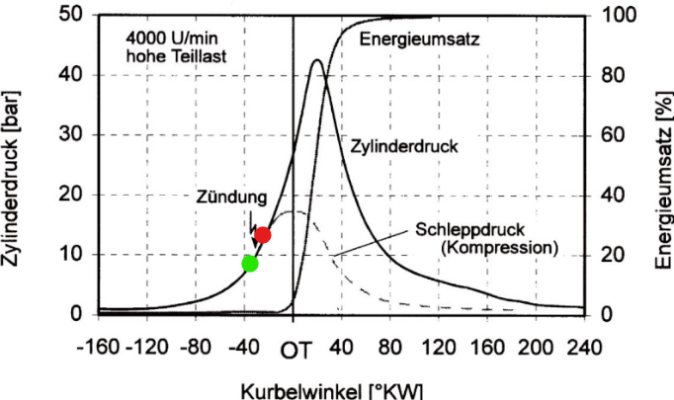

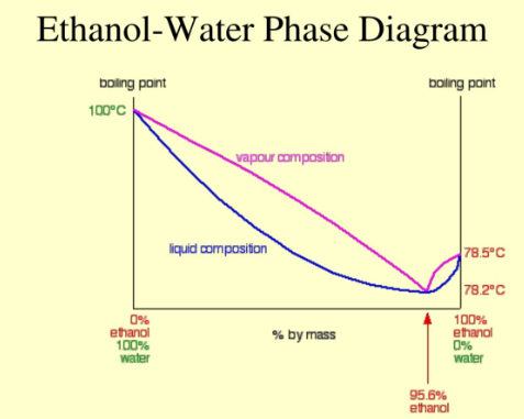

I marked the E10 in the diagram with the green dot. That means if you increase the water content only a few percent, the fuel will separate into two phases. Therefore you must use 100% water free ethanol for production. Destillation gives you only 96% of ethanol (azeotropic mixture). When E10 absorbs water from the air it separates into two phases when it reaches around 2%, that is the reason why it is only stable for 3-6 month. Then you have a Ethanol/Water phase which ignites bad and a low octane fuel phase.

Without ethanol you would have not water in the fuel in the first place. Had the wrong number in my mind, phase separation starts at 0.5% water content (just looked into my documentation). Every time you handle the fuel, water from the air will be absorbed.

I marked the E10 in the diagram with the green dot. That means if you increase the water content only a few percent, the fuel will separate into two phases. Therefore you must use 100% water free ethanol for production. Destillation gives you only 96% of ethanol (azeotropic mixture). When E10 absorbs water from the air it separates into two phases when it reaches around 0.5% (I had a wrong number in my mind, sorry), that is the reason why it is only stable for 3-6 month. Then you have a Ethanol/Water phase which ignites bad and a low octane fuel phase.

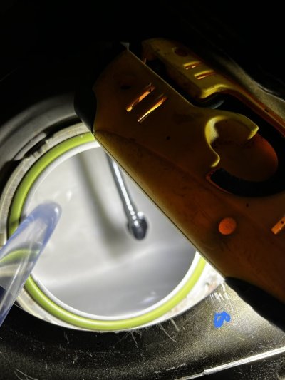

I’m in Chicago area. We have had E10 since 2000. In 2020, I had electrical short with my gas gauge. I opened up the gas tank. Here is what 12 years of E10 and 3 years of E85 did to my stock gas tank. See any evidence of water?
This is really a nonissue.

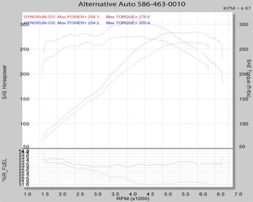

I have a question to the people who can tune:
What is the difference between a 91 and 93 octane tune, when our 4.6 was designed for 87?

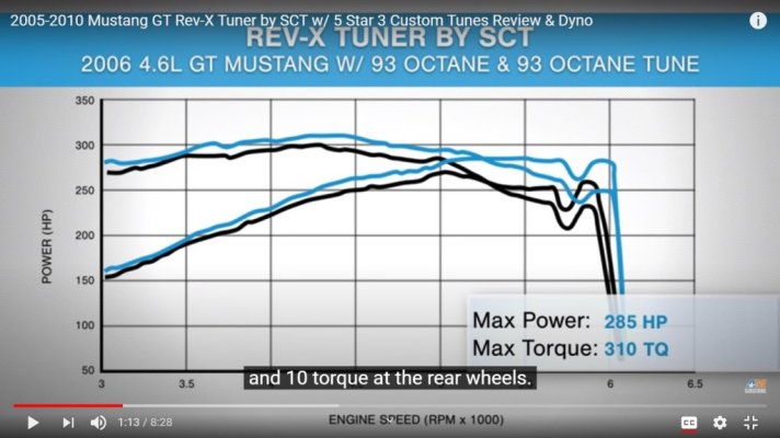

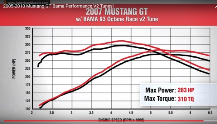

The stock tune only allows for a maximum WOT ignition advance of 26 degrees, which allows the engine to run on 87 octane. However this limits performance and blunts throttle response.
A 91 or 93 octane tune increases maximum WOT ignition advance to 30 or 32 degrees respectively. Part throttle ignition advance is also increased from low rpm right up to the rev limiter, and this is why the torque increase is so impressive compared to stock.
93 Octane BAMA Race Tune.jpg93 Octane Rev-X Tune.jpg93 Octane SCT Tune.jpg93 Octane Tune.jpg
That I don't understand. It is still NA so no change in compression, if you ignite earlier this is independent from the octane number. Does the 91/93 burns slower? Or, with 91 you can lower the safety margin and the possible ignition angle is also 31 with 87?
StockishS197
Dec 24, 2024
494
458
Houston
93 is more knock stable than 91, so it resists pre-detonation (knock) better than 91.
When you advance the timing, you are moving the ignition event further BTDC, thus more push down, however at the tradeoff of higher cylinder pressure and likelihood of knock.
Most 93 tunes for 3vs run up to 32 degrees of WOT spark (+\- 2 degrees). Outside of WOT, part throttle tuning is greatly improved with higher spark advance too.
The stock tune is super conservative at 26 degrees to run 87 safely.
This is a gross oversimplification of tuning, but you get the idea.

I think 31 means 31 degree before TDC, so the compression is lower than at 26 when the spark comes?
PS: found diagram
