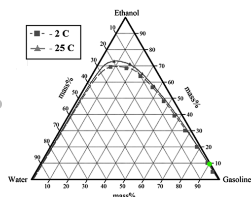

GriffX
Sep 28, 2017
1,511
1,035
Rural Germany
Interesting comment Griff as I've heard other local mechanics and people who work with petrol engines in general comment that E10 is full of water. I don't read into this sort of stuff as my head is full enough. But I do see by checking Google that the UK uses bioethanol in which contains 3-4% water. That's very little so I don't see an valid argument for "its full of water". I do see however its hygroscopic which is a concern as transport, storage and other factors could raise the water content more in the right climate before you take ownership of it. Now I have gone down the Google rabbit hole on E10, the more I read the more concerning it is.
I marked the E10 in the diagram with the green dot. That means if you increase the water content only a few percent, the fuel will separate into two phases. Therefore you must use 100% water free ethanol for production. Destillation gives you only 96% of ethanol (azeotropic mixture). When E10 absorbs water from the air it separates into two phases when it reaches around 0.5% (I had a wrong number in my mind, sorry), that is the reason why it is only stable for 3-6 month. Then you have a Ethanol/Water phase which ignites bad and a low octane fuel phase.
