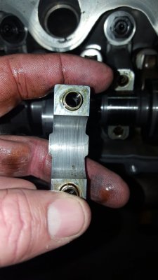

Well it looks like the valve train and heads survived. I pulled most the cam bearings and they looked good. Worn, but fine. Cams looked good too. Even though from the photo it looks like there are some good marks, when scratched with a finger nail, nothing catches the nail and it feels even throughout. So far so good. The more money I save the better.
Tomorrow I'll drain the oil, pull the pan and then check the bottom end.
I'm leaning towards a when thrust bearing, causing a rod bearing too wear prematurely and then fail. This is based on what on first inspection of the mating of the flywheel to the converter, I found washers and a few shims to fill the gap. Which means there was no gap which is bad. I will measure the shims later just to see what the stack up to. 20180306_223753.jpg 20180306_223746.jpg

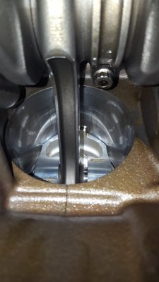

So far, so good. Hopefully all my cylinders and pistons are good. Even if my pistons are good, in order to make things all good again, my cylinders may need to be punched out a little. But I don't know enough about it to really have an opinion.

What tf is that metal? It has to be a non engine part, that short block looks great. I would be surprised if it needs pistons and a bore.
