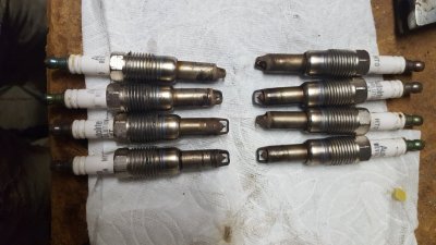

Curious to see the piston tops and the spark plugs for any signs of detonation.

Pulled the plugs. One side you can see rust from a leaking head gasket. One plug, front passenger side, was a little tight coming out. Had some carbon build up. 20180316_212542.jpg
