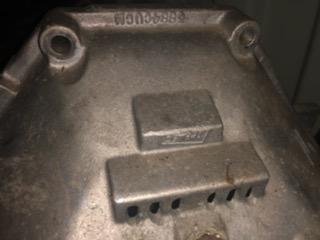

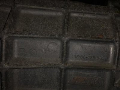

Here are the pictures the seller sent me. They aren't very great, but they have a few numbers, but nothing like what you're referring too.

IIRC, the TUET number is cast in somewhere and is enough to get the ratios but not the exact build date. But I'm not 100% sure anymore. Its been several years since I did mine.
Realistically, any of them will work well. But a 2.66 1st gear may need a ring and pinion change to get what you want for overall gearing.
