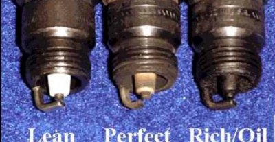

That photo is wrong. White=Lean, Brown=Good, Black=too much fuel/rich
Huh? That's what the photo shows lol
Sure the leaner you are the more white you get. But you get the idea just first pic I grabbed off google.

The one on the left is marked LEAN. That plug is brown, brown is GOOD. The two outside plugs are labeled backwards.
I can see what ya mean. Didnt look that close here is a better google pic.
