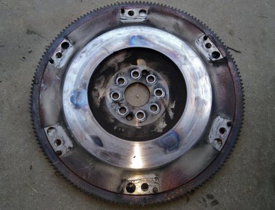

Took the wife's Shelby for its first drive today, right over to a friend's house, for the clutch swap.
And yeah, it was due (overdue).
The old flywheel was hot-spotted like crazy, I even got some slip on the way to his house.
Going back tomorrow to finish it up, we had to stop early today, he had a few other things to get done.
Today we got the old stuff out, the new McLeod braided clutch line in, new Ford pilot bearing, new Ford slave cylinder/throwout bearing, and the new McLeod flywheel installed.
Tomorrow the fun of getting the huge TR6060 back in its place.

Finished the clutch job with my friend, had a setback when the McLeod clutch line kept popping off at the top connector, had to swap back to the factory fluid line.
But it feels good, driving it back to the house now :)
