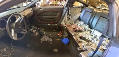

Pulled out all my carpet last night. The padding under the carpet was completely saturated. I don't know how long the cowl grommets have been leaking but apparently it's been for awhile. Rust on most of the floor but thankfully the only part rusted through is the driver's side floorboard.
Now I gotta figure out the best way to clean out all that rust and patch the floor. Sigh...

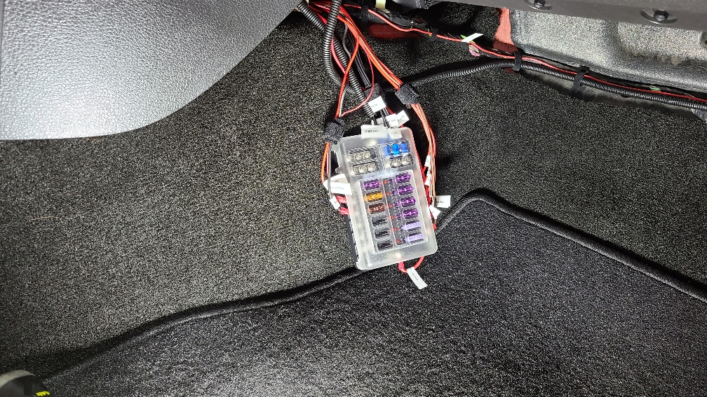

And...Done. Time consuming, but worth it.
Now all accessories, i.e., line lock, gauges, shift light, etc., are ran through this box. No more "add a circuits" in the SJB or elsewhere. One spliced switched 12V and one ground from the car. Still have 6 ground and 3 power posts for the future as needed. Left enough slack that it can be pulled down to the center of the foot well for access.

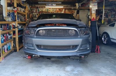

Both my wife's and mine got their share of fresh Amsoil 5W50 oil and new Motorcraft filters today.
On mine I tried to remove the cats to inspect them and see if they're breaking up (started getting a tinny rattle on accel).
Harder to do since I tack-welded the back of the cat pipes to the H-pipe, and the H-pipe was tack-welded to the rear pipes when it was installed. So I have to break or cut tack welds. And some of these tack welds look like full-on weld spots. After fighting with it for a while I decided my exhaust project/repair will have to be finished another weekend. I hate exhaust work, by the way.
And after this is all done I still need to put in a new thermostat since the lower-temp one in there started popping codes at the end of last year. Yaaaayyyy ...
Yes, it's filthy.

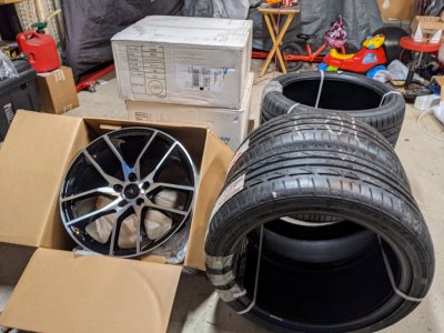

This weekend I got the new tires mounted, inspection done, registration renewed and then for the first time in months took the wife and baby out for a spin!
Now I just need to find the time to do the front control arms and underdrive pulleys!

You're like me.. build shelves everywhere. Never enough storage space. ;D

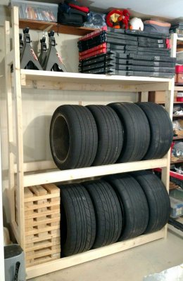

Lol yeah I built all the shelves in the garage, and they're done in such a way that any plumbing pipes can still be worked on, if needed.
Also built more shelving for the large canvas tent out back, including repurposing some pallets for garden tools storage (thanks Pinterest for the ideas, lol)
