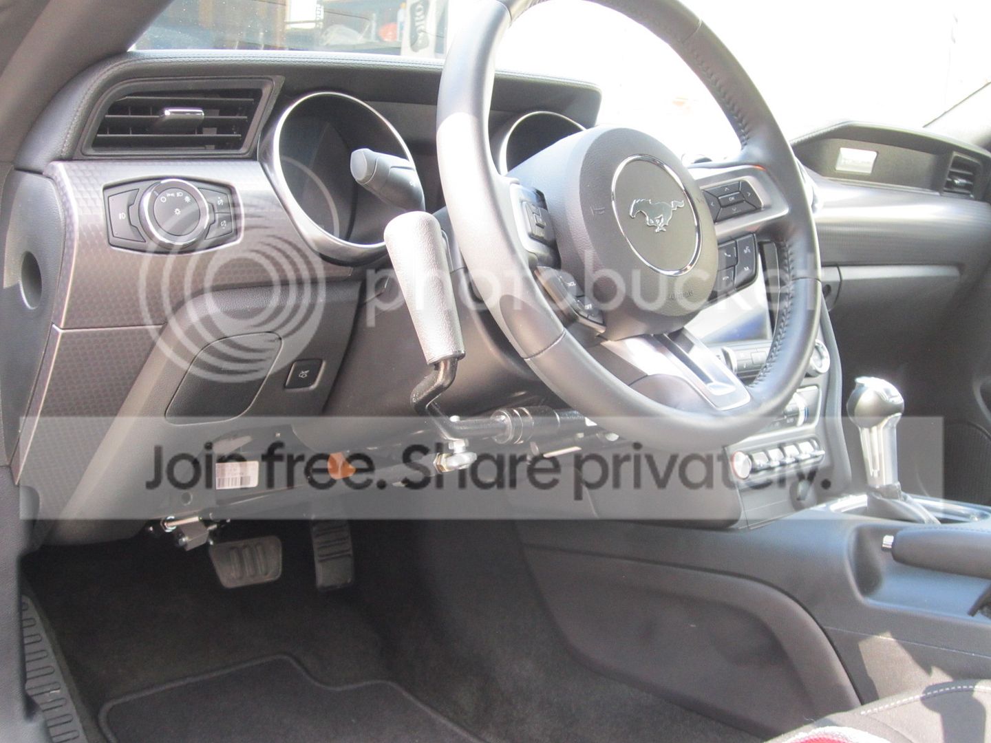

The dealer probably considers hand controls to be "aftermarket" unless they're specifically a special production line option (complete with a code not readily available on the regular order sheet). Any chance that something in the installation of your hand controls is behind the P0600?
I have no idea what might be involved in reworking the controls or even their design such that they don't send "unexpected" data to the ECM or any other module. Perhaps one of the hand control connections or even one of its components has an intermittent that the far greater g's experienced on track are screwing with that normal street driving won't.
I dare suggest that most anybody qualified to fit a car with hand controls is not going to expect any of the cars he might ever work on to see 20 minute track sessions where 1g is repeatedly approached/exceeded unless he was specifically informed of that intended use ahead of time.
FWIW, I have seen at least one person in your situation running at a track day.
I have no idea what might be involved in reworking the controls or even their design such that they don't send "unexpected" data to the ECM or any other module. Perhaps one of the hand control connections or even one of its component has an intermittent that the far greater g's experienced on track are screwing with that normal street driving won't.
Norm
Nothing with the hand controls would generate a code, the hand controls just attach to the armature of the current pedals and the steering column, the pedals are still in place so my wife can drive it. My tilt on steering is no longer functional and lower knee panel w/airbag is removed.
I rock back on lever for throttle (turns 180*) and push forward for brake, so throttle and brake can be controlled simultaneously, great for power braking and doing burnouts... :)
