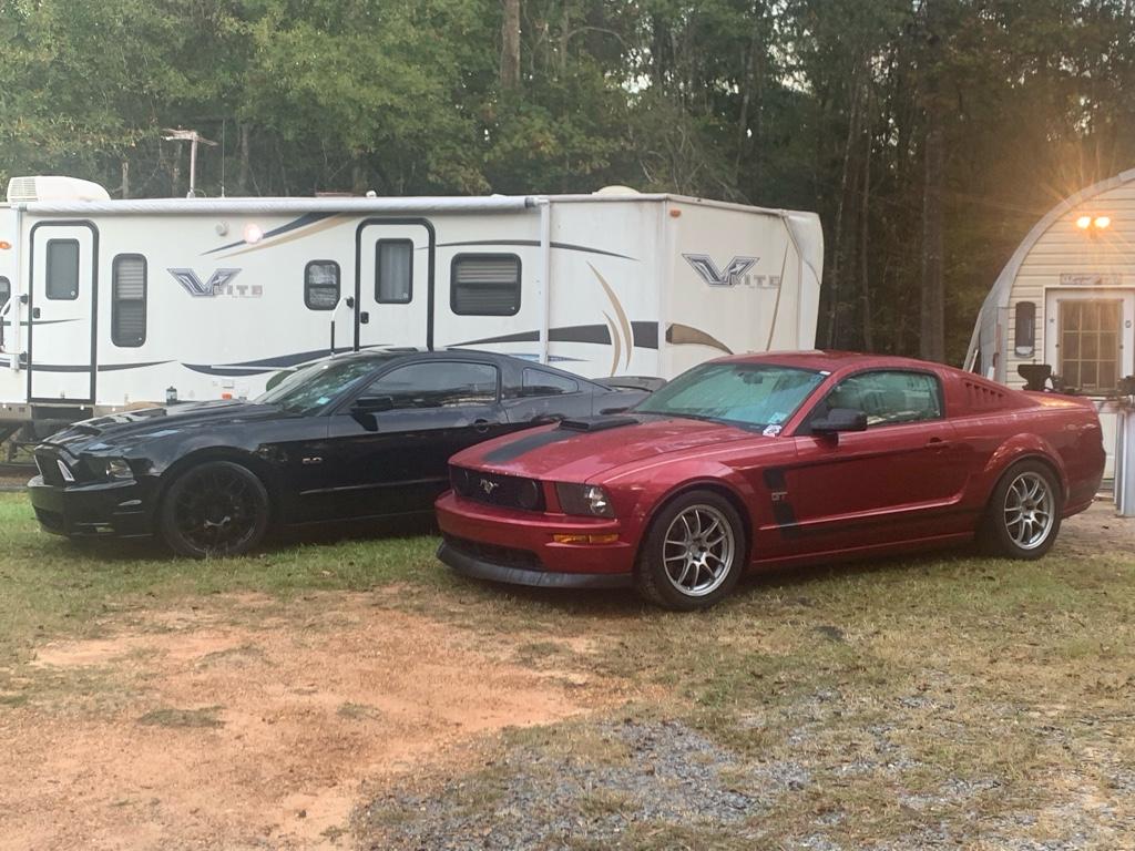

So at this time the car has had the cats removed and an airaid cai. Appears to be stock other than that.
Just with the cats removed it is loud as hell! I’d like to quiet it down a lot!
I assume it’s been tuned, but have no way of knowing at this time. Has a light on the dash for the traction control and the advance trac or whatever it’s called. But no other warnings. I haven’t scanned it yet to see if there are any codes.
Took it for a short drive tonight. It runs strong, no noises, no smoke(except off the the tires).
More to come.
